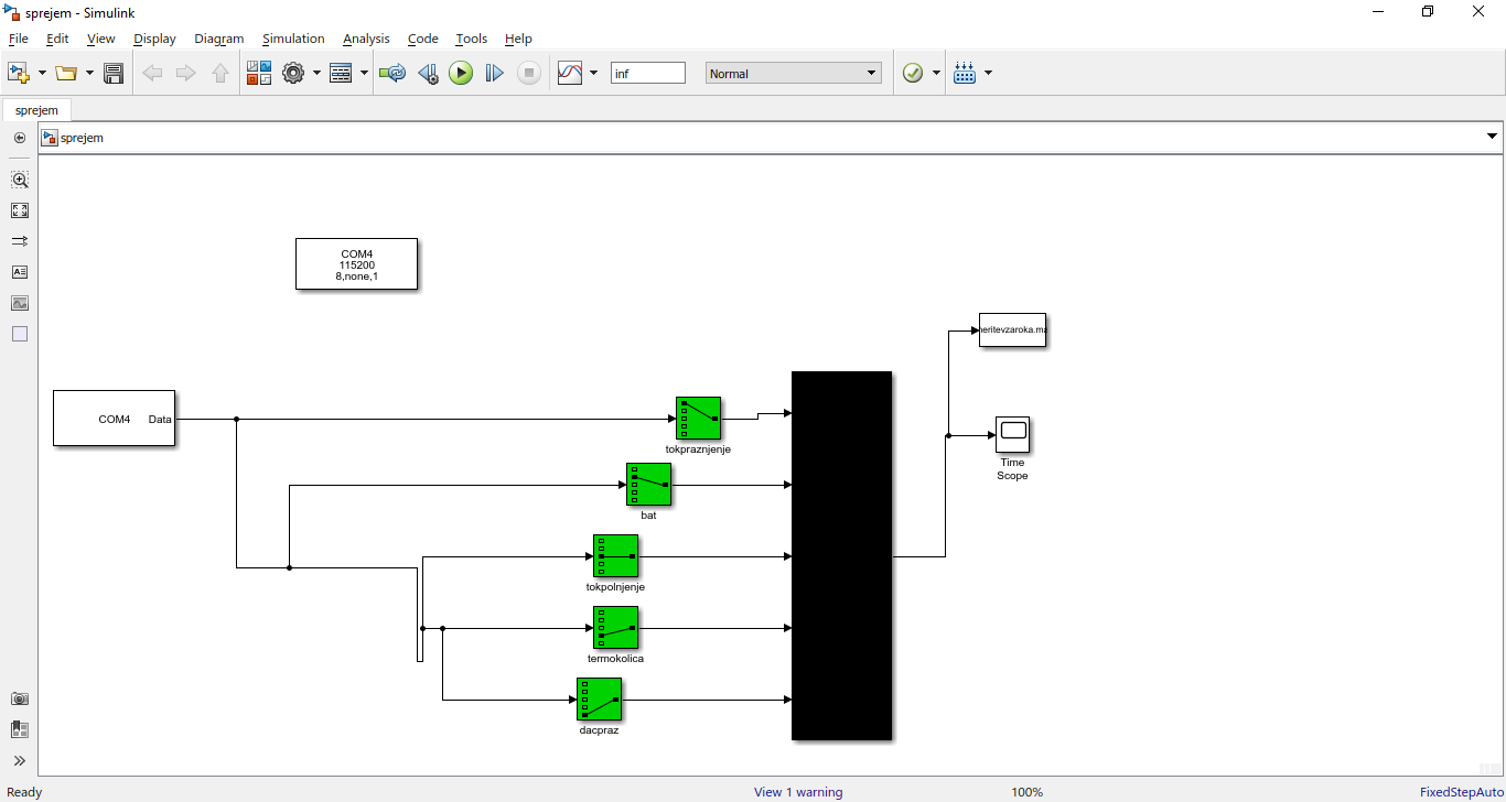

  • Here is my receiving setup (the program running on my PC) so far. I'm receiving a bunch of ADC data, sending it through the mux block to demux it (for some reason this works with a mux, not a demux) and then sending it to the scope block and the to file block.
    I would now also like to send some parameters back, but I'm honestly not sure how. Exact instructions would be amazing.
    You can see the serial_flash_programmer Utility in C2000Ware. This is a C++ VIsual Studio project which sends and received data to the device.
    Also, as long as you can open the COM port, it should be easy enough to write code to send data to it. Especially since you are able to read from it.
