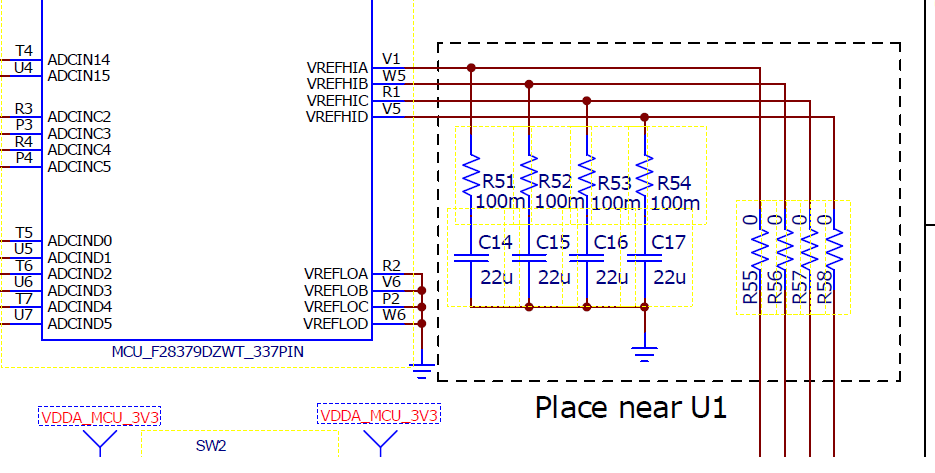

In controlcard demo (TMDSCNCD28379D),as shown in the diagram below, we can see that the reference  pin(VREFHIA VREFHIB VREFHIC VREFHID)  is connected to the filter capacitor through 100m ohm.I thought it was a 100mΩ (0.1Ω)  connected TMDSCNCD28377D voltage reference  pin and a filter capacitor (22uF).Devin Cottier,a TI engineer, explained the reason that is "22uF is a huge load for an op-amp to drive, even one that is good at driving capacitive loads like OPA350.  The 100m ohm resistor is to ensure op-amp stability. "

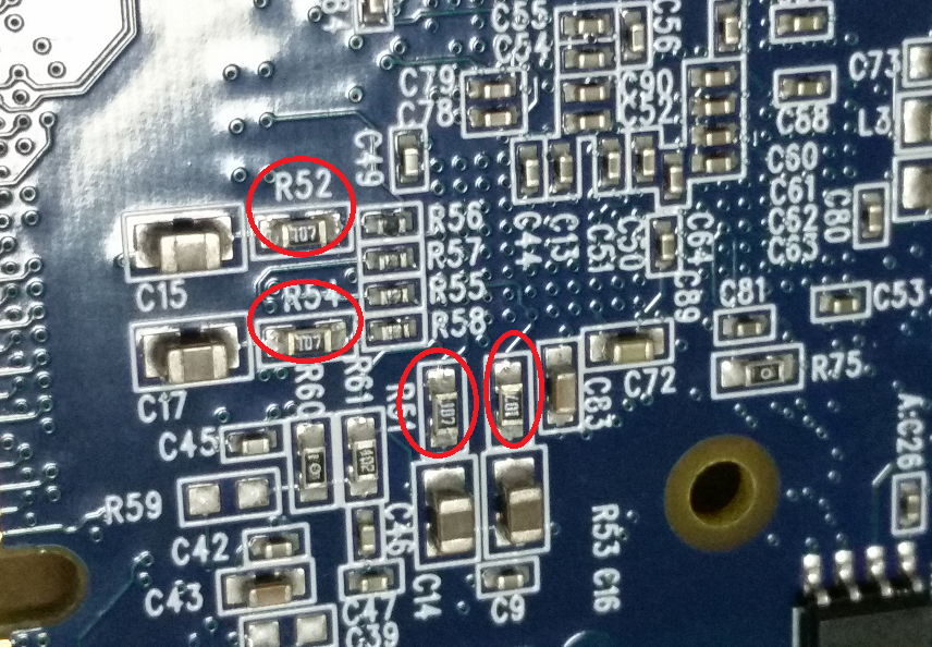

But when we bought controlCAR, we found that  The R51~R54 value is 100MΩ(100X10^6) resistors.My questions are as follows. I look forward to your help.
1, is R51~R54 100mΩ (0.1Ω)resistor or 100MΩ(100X10^6) ?Help explain why this resistance Value is used Again.

  • 1, it should be 100mΩ (0.1Ω). On certain revisions of ControlCard wrong value was placed. You should be able to find the topic on this on this forum. The resistance is used in order to prevent th opamp driving it to oscillate.
