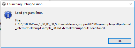

when I program with given examples to my custom board F28069F through Launchpad  F28027F.
It shows error in debugger window
what should be the problem?
how fix it??

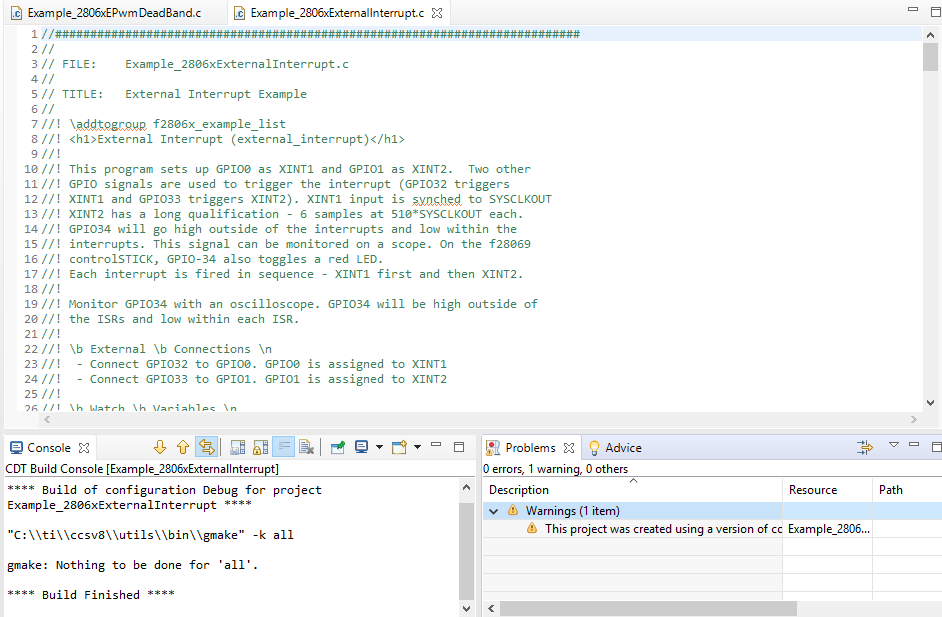

    First of all it feels like you're project has some errors. Can you "Rebuild" your project and check your Console Window.
    Gautam

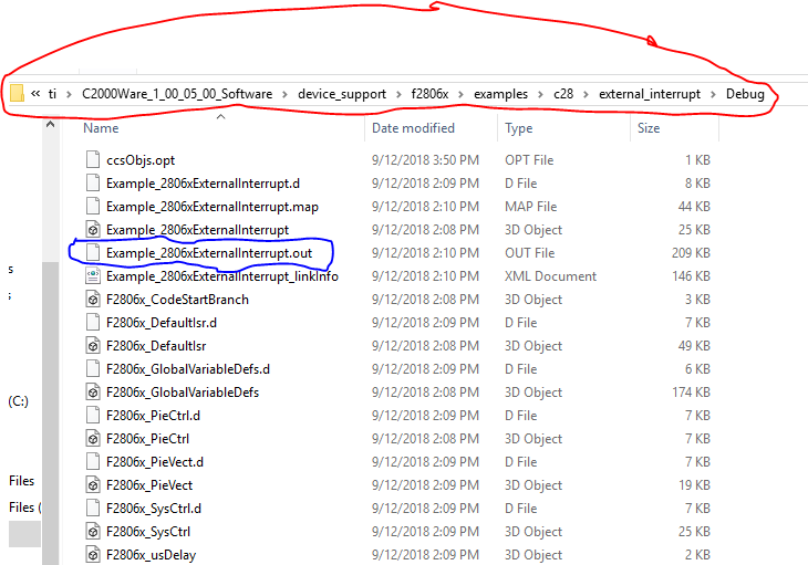

    Please check if the location of .out is correct?
    Are there any build errors?
    Thanks and Regards
    Harshmeet
  • there is only 1 warning..!!
  • I don't understand .What is the location of .out.
    there is not any build errors
    Thankyou
  • There is location from where it is picking the .out that is shown in the error.
    Is that correct?
    Harshmeet
  • i am sharing u a screenshot of location of .out file

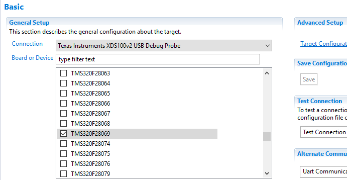

  • Yes ,it is TMS320F28069F!!
    In target configuration, selected device is TMS320F28069
    And Selecting j tag XDS100V2
  • My target configuration is shown above,
    still I get error
