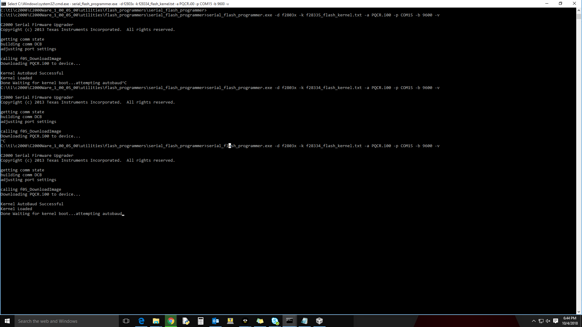

Thank you very much replying,I have tested loop back test and i tested by using following command in command prompt.
"C:\ti\c2000\C2000Ware_1_00_05_00\utilities\flash_programmers\serial_flash_programmer>serial_flash_programmer.exe -d f2803x -k f28335_flash_kernel.txt -a PQCR.i00 -p COM3 -b 9600 -v"
i got auto baud successful but application auto baud successful not coming,please confirm me my code is flashed into controller or not,because ,in one of my previous blog you told that at the end "appilication auto baud successful" will come am i doing anything wrong in the arguments in command prompt.
Iam sharing the screenshot ,Please find the screenshot for reference

Iam not erasing anything manually,iam sending the command line in command prompt ,below is the command line,i don't have any f28334 kernel ,so just i edited f28335 flash kernel name and put it in arguments,please send the f28334 kernel,please have a look at below command line am i doing anything wrong in this command prompt ,please correct me,our controller was TMS320F28334
After running the above command in command prompt,it was coming upto "done waiting for kernel boot ...attempting autobaud" after that it was hanging and expecting at the end "Application AutoBaud Successful not coming",please see the below message coming after running command

C:\ti\c2000\C2000Ware_1_00_05_00\utilities\flash_programmers\serial_flash_programmer>serial_flash_programmer.exe -d f2803x -k f28334_flash_kernel.txt -a PQCR.i00 -p COM15 -b 9600 -v
I'm waiting for your kind reply,please reply soon
I'm stuck up here,i already crossed my dead line ,past months am trying,kindly please help me to sort out this issue,i'm sending screenshots please find the attachment

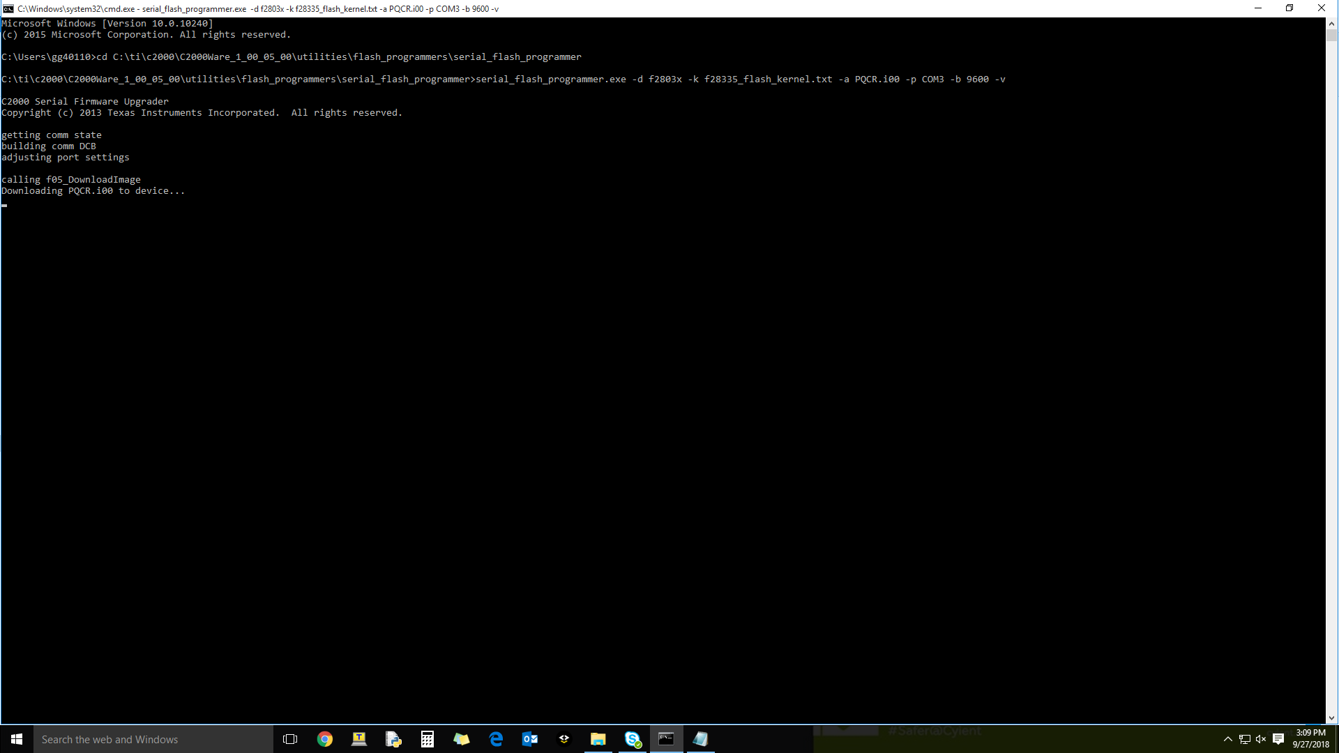

From previous blog you are saying that you can't share f28334 flash kernel file without that how can i flash my code into controller,my client is going to escalate the project, to sort out this issue ,at least please provide f28234 flash kernel or any below flask kernels which is suitable to our controller , because in c2prog, i can able to program with f28234 flash kernel file into my f28334 controller and it was working.
Because here we are using .out application file which was provided by customer, i can't modify that file, by using C2000Ware command prompt only "sci" am flashing into controller,iam sharing screen shot please find the attachment
