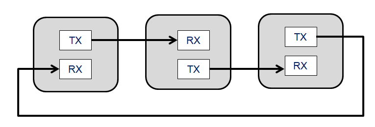

 2) For daisy-chain-like connection, how to do the handshake?
Here is my assumption: the device 1 send a specific PING to device 2, then device 2 send another PING to device3, …., device N send a PING to device 1, so device 1 can determine whether the communication is successful by detecting whether the PING from device N is a pre-defined one.  Is this can be an effective handshake process?

    For daisy chain, each device (index i) must handshake with the FSITX of deivce i+1 and FSIRX of i-1.

    I also think that it would be a challenge or star connection with FSI.  As mentioned, for daisy chain, each device (index i) must handshake with the FSITX of deivce i+1 and FSIRX of i-1.  However, I have tested the handshake mechanism given in example project(P2P connection), handshake needs both TX and RX connection between 2 devices, so how can it be used to daisy chain as shown below?   The handshake is used to guarantee both transmit and receive working for two chips, am I right?

    2. The TX module of each device in the daisy chain must send a ping to the next device untill all devices have successfully received the ping.

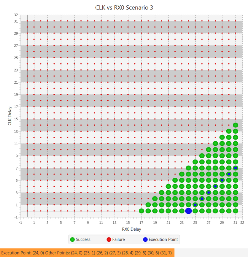

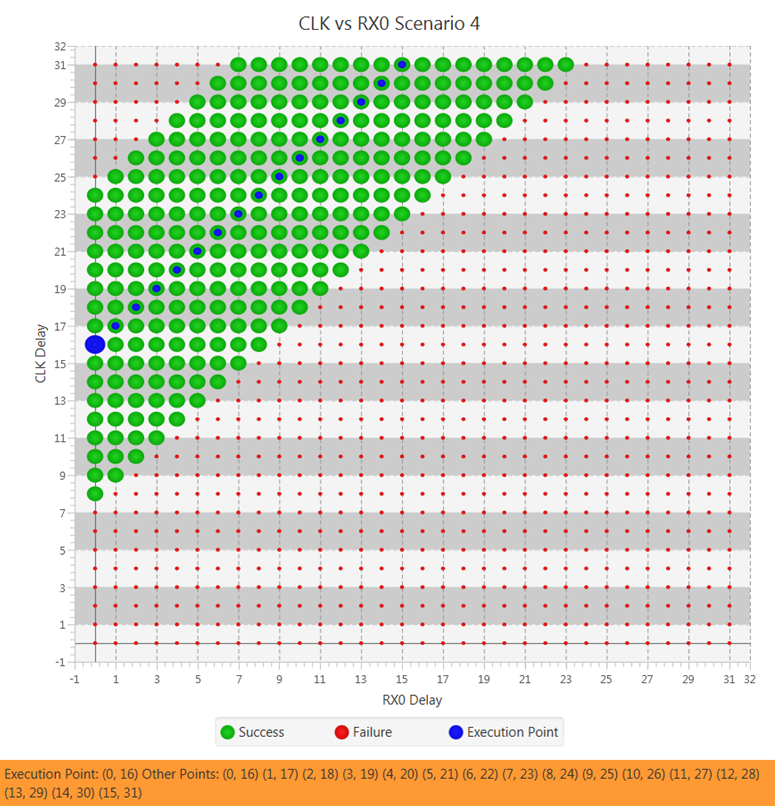

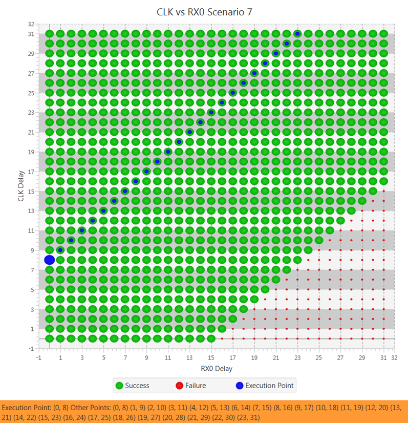

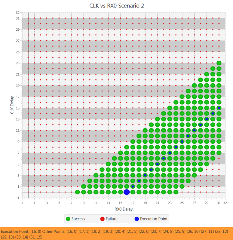

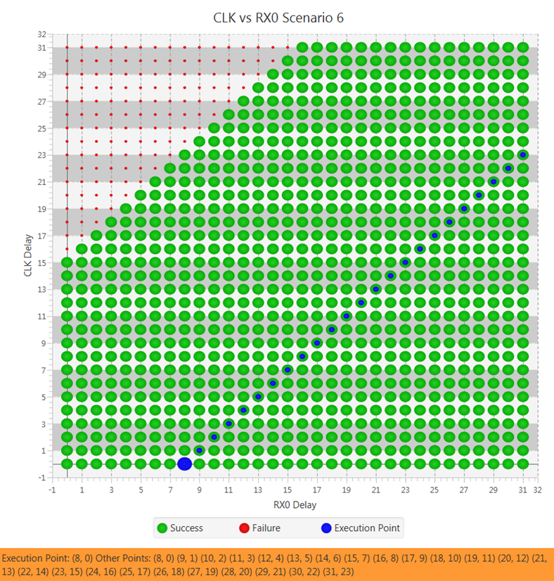

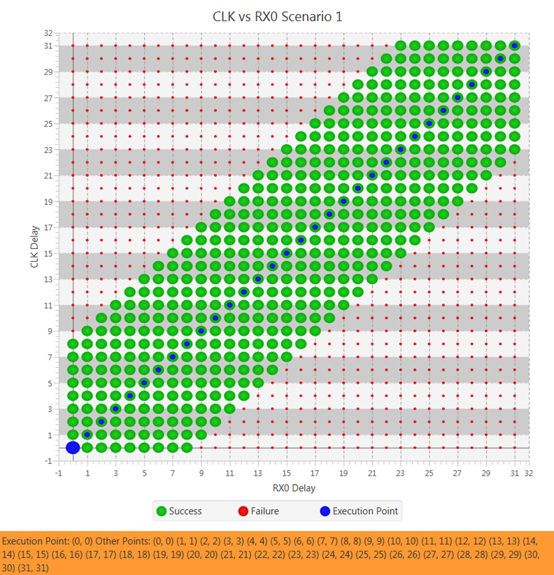

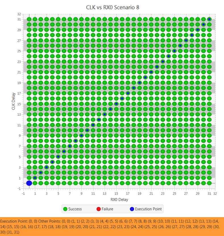

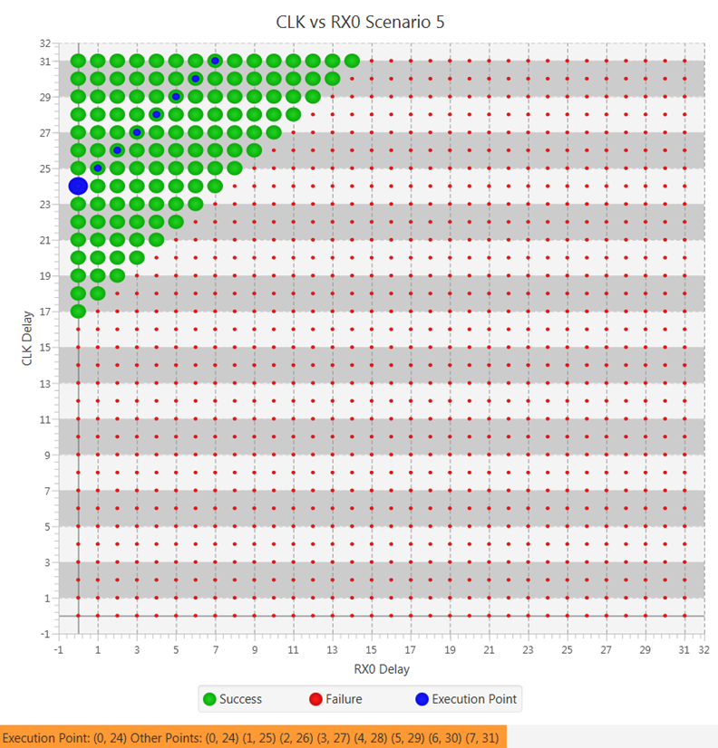

  • So there are 3 signals you need to worry about. FSIRXD1, FSIRXD2 and FSIRXCLK. First you want to choose the optimal delays for FSIRXD1 and FSICLK, so what you can do is run the FSI handshake (USING SIGNLE DATA LINE) with a timeout implemented between the two devices, and sweep through the 2 * 32 possibilities of  delay line control for RXD1 and CLK. (keep CLK delay = 0, RXD1 delay 0-31 and then RXD1 delay  = 0 and CLK from 0-31) . Check to see what value of RXD1 and CLK delay causes successful ping transmission. This way you can find the optimal delay between CLK and RXD1.
    It will be one of the following scenrarios. Again the data bellow checked every possible DELAY setup but you only actually need to check 2*32 (instead of 32*32).
    The green shows successful handshake, the blue shows optimal points.
    knowing the set of optimal points for CLK and RXD1, you can sweep through the [optimal CLK, optimal RXD1] delays  vs RXD2 delays (32 possibilities) and find the optimal CLK, RXD1 and RXD2 delays.
    Selecting the blue optimal point to be centered in the green allows for the system to operate with the best margins.
    I'm sure there are confusing parts in this so let me know what your questions are!

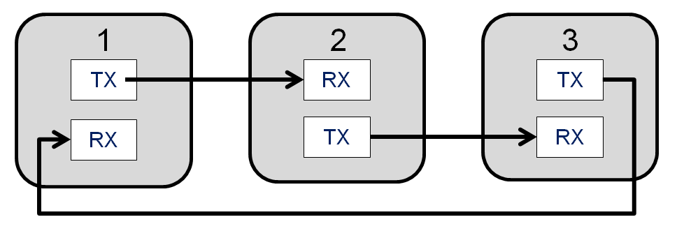

    1. I'd like to further confirm the handshake mechanism for daisy chain connection.
    Supposed a 3 devices connection,  for device 1 handshake: device 1 sends a ping1 to device2, then devce2 send ping1 to device 3, then device 3 sends ping1 back to device 1, at last device 1 judges whether the received ping is ping1, if so, handshake is completed.  Then, the same process happens to device 2.  Is the above right?

  • You are correct on your daisy chain handshake. After ping 1 is successful try to do another round of pings for robustness.
