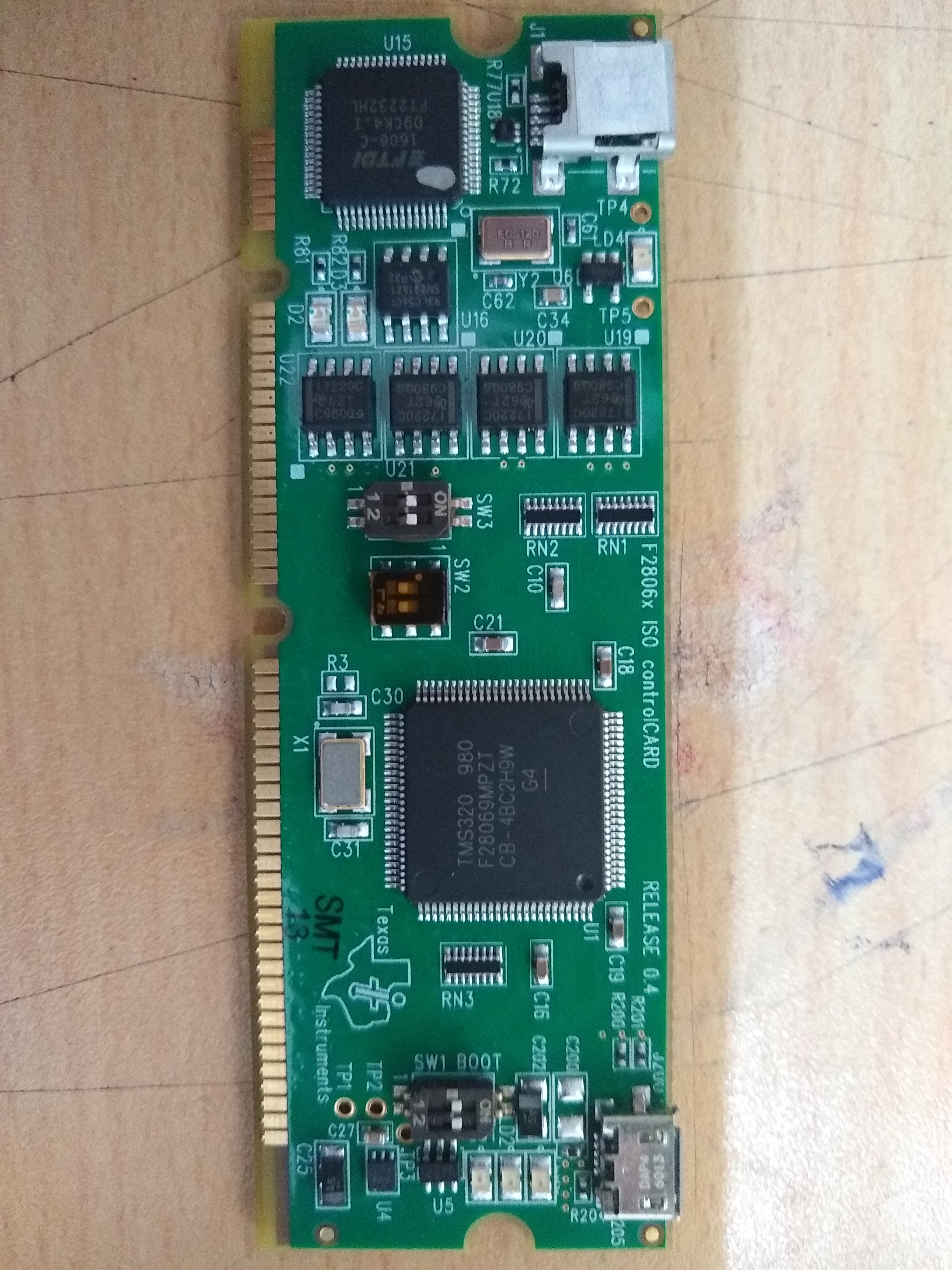

  •   Hi
    Good Morning Sir,
    I follow same paper that u provide me yesterday.
    But again it is not working.
    I am doing by Use of UART via [M3] on the HVMTRKIT baseboard.
    U can see the pic ....
    If u have any demo video plz provide..
    Please Clearly tell how to  run the motor by using your kit...
    I am confusing with the paper..
    Thank You
    Shikhar
  • It seems you're using the on-board XDS100, which is not appropriate for the ControlCARD you are using. Per this recommendation:
    Do NOT use the onboard XDS100 emulator when using a controlCARD with its own onbard emulation (ex: TMDSCNCDF28069MISO)
     populate jumper M3-J5 to disable emulator on HVKIT.
    You will need to populate M3-J5 jumper and instead program the device through the ControlCARD emulator.
    Sean

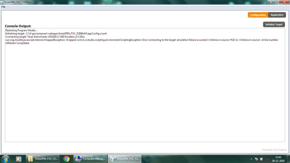

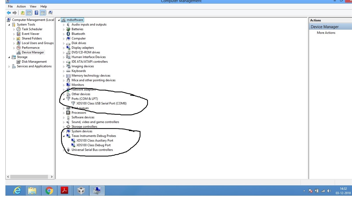

  •  Hi Sean,
    I am using AC power to provide the Kit and my using usb jtag emulator cable to connect Kit to my Pc.
    I put SW3 Switch 1 in ON sate and what about other Switch Sw1 and SW2 state?
    J9 not populate,j2,J3,J4,J5,J7,J8 are populated.
    Bs1 connected to Bs5.
    By Doing this, on control card two led Blinking one is green and other is Red.
    I am using InstaSPIN Universal Gui Software For F28069x.
    All these are correct according to the document u mention and by your suggestion.
    When i am not  popualting M3 J5 then in my PC it is showning Com Port and XDS 100 Class Port, that i attached in the pic.. otherwise when i populate M3 J5 then  it will not showing Com Port and XDS 100 Class Port in my Device manager.
    Again It  showing same error
    Restarting Program Model...
    Initializing target : C:\ti\guicomposer\eclipse\workspace\.metadata\.plugins\com.ti.binding.program\appConfig.ccxml
    Connecting target: Texas Instruments XDS100v2 USB Debug Probe/C28xx
    sun.org.mozilla.javascript.internal.WrappedException: Wrapped com.ti.ccstudio.scripting.environment.ScriptingException: Error connecting to the target: emulation failure occurred (<Unknown source>#14) in <Unknown source> at line number 14Restart Completed.
    I in my opinon when i populate M3 J5 my is not responding ...
    I already go the document u suggest me...i already done according to that..
    Please tell me what i have to do...
    Thank You
    Shikhar Gupta
  • Are you connecting to the debugger (mini USB) port on the control card instead of the USB port on the base board? You need to populate M3-J5 and connect to the control card debugger.
    Sean

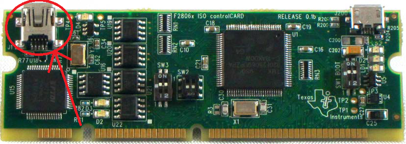

  • The default mode for SW2 should be ON-ON, can you confirm this?
    Please also ensure you are using the correct USB connection on the Control Card. I've marked the correct one in the picture below
    You can find a listing of which LEDs are reporting which status update in the Piccolo F28069M controlCARD Hardware Guide I linked earlier. Please check the LED listing and confirm the LED for JTAG logic is powered
    Sean
