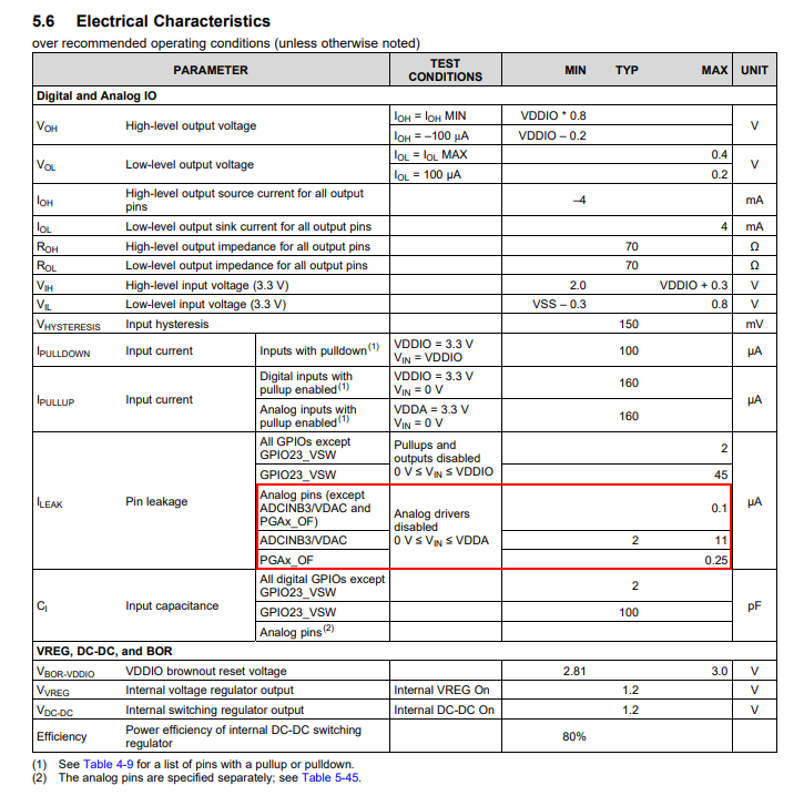

  • Hi Sheldon,
    The effective source resistance on the A4 channel is (3.65kohm || 650kohm) + 1kohm = 4.63kohm.  This would definitely be considered very very high.
    If the input drops 0.3V, then the parasitic current is 0.3V/4.63kohm =  65uA.   This is much larger than the specified leakage current (see below) so either there is another path for static current dissipation or the input has been damaged via ESD or EOS.
    Note that during active operation we might expect and additional current of up to 250kHz*(12.5pF*2.5V) = 7.8uA.  This might result in an additional 35mV or so drop.
    Do you see this on the ControlCard or Launchpad with an equivalent source impedance, or only the customer's system?  Is this only in one system, or many?  This seems like ESD or EOS damage to me.  I see that there is an input protection diode on the input side, but there is no series resistance after the diode.  Series resistance between the diodes is needed to steer current away from the internal protection diodes to the external diodes in case of an over-voltage event.  Alternately, is it possible the input went below VSSA at any point?

  • Hi Sheldon,
    Quick comments:
    The S+H capacitor is 12.5pF. In the worst case the external source will have to charge it 0 to 2.5V on each sample. Samples are occurring at 250kHz.
    Mathematically C = Q/V and I = Q/t
    C = 12.5pF
    V = 2.5V
    So Q = 12.5pF*2.5V
    t = 1/250kHz
    So I = 12.5pF*2.5V*250kHz
    I don't see how this could be an EMI problem, unless you are suggesting that EMI somehow induced a transient ESD or EOS event?
