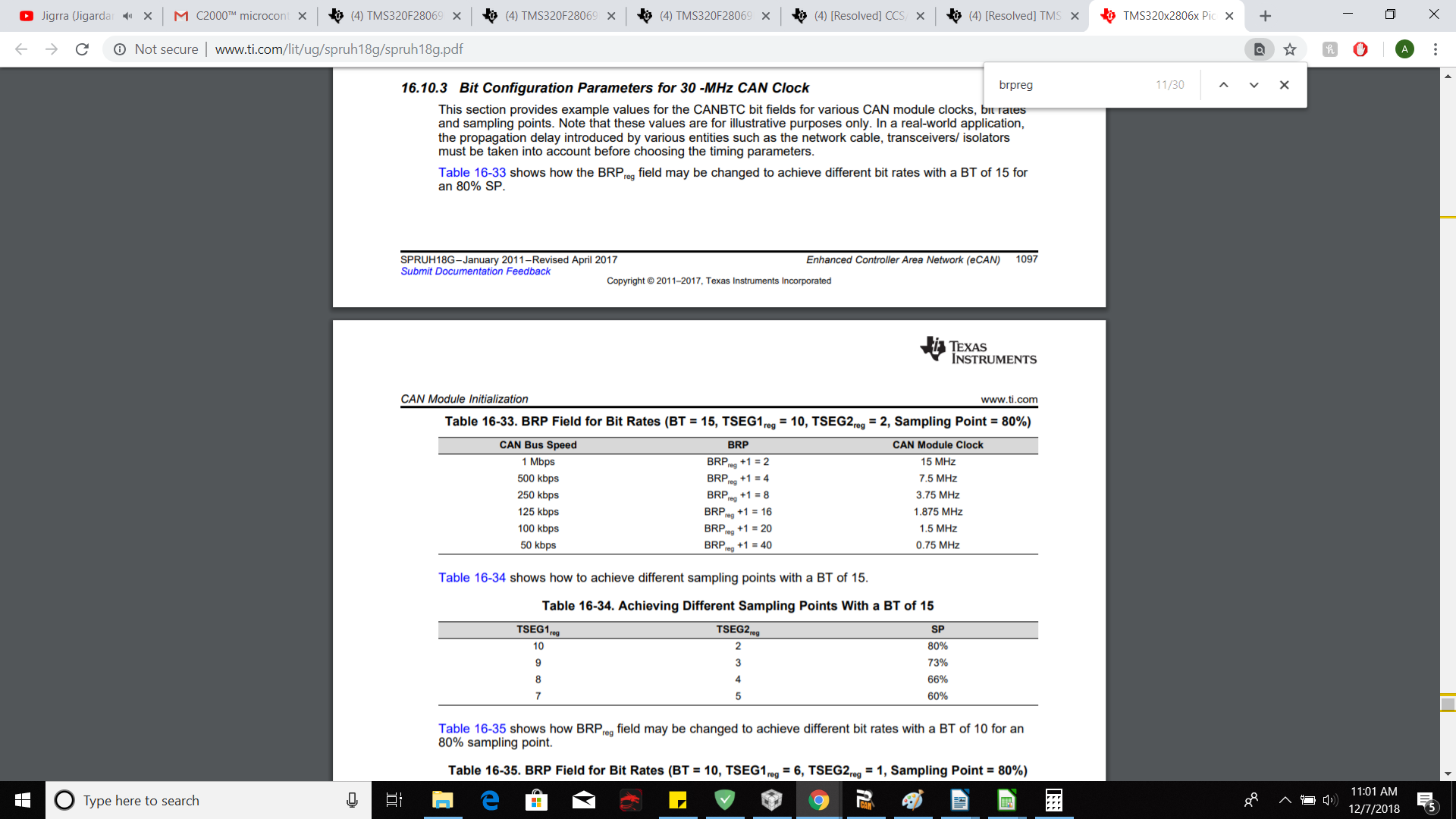

TMS320F28069M: ECanaShadow.CANES.bit.CCE never sets 1, in CAN receive mode I can see the waveform on CANH and on CANL but the registers does not read the value
Part Number: TMS320F28069M
I am using PCAN to transmit message which is set at 1M bits/sec  and I am using ECAN on F28069 as Receiver end
ECanaShadow.CANBTC.bit.BRPREG = 1;
ECanaShadow.CANBTC.bit.TSEG2REG = 2;
ECanaShadow.CANBTC.bit.TSEG1REG = 10; , these are the values I have set on  ecan SIDE TO SET IT TO 1M BITS/SEC.I am sending data from PCAN at 1ms cycle time.

    ECanaShadow.CANBTC.all = 0;
    /* The following block is for 80 MHz SYSCLKOUT. (40 MHz CAN module clock Bit rate = 1 Mbps
       See Note at end of file. */
    ECanaShadow.CANBTC.bit.TSEG2REG = 2;//4
    ECanaShadow.CANBTC.bit.TSEG1REG = 10;//13
    ECanaShadow.CANBTC.bit.SAM = 1;
    ECanaRegs.CANBTC.all = ECanaShadow.CANBTC.all;
