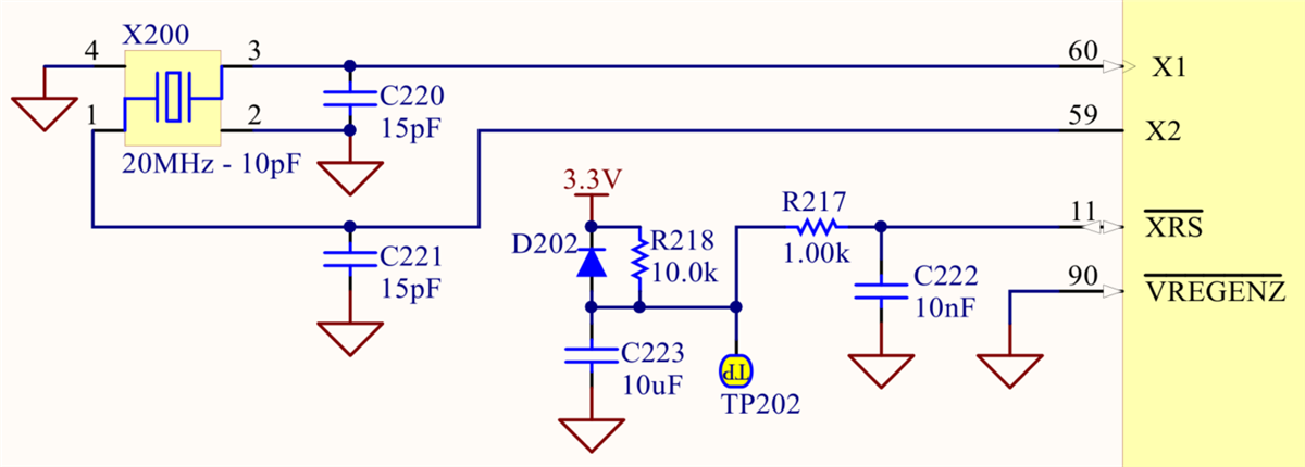

I have a board with a TMS320F28069 MCU, and the following circuit for the XRS and Crystal pins.
Note the intention to conform to http://processors.wiki.ti.com/index.php/WDFlag_on_Piccolo section 2B).
I am able to distinguish between watchdog, clock faillure and power on:

What I observe is not that. Shorting the clock capacitors, causing a restart by the NMI, will reset the device with XRS pin high, without any observable glitch on the testpoint of my circuit... XRS pin IS HIGH at the ~3.7ms delay, but WDFLAG is still low.
Also, I wanted to validate our firmware for watchdog handling, and simply tied XRS to a 3.3V source BEFORE power-on of the main circuitry. WDFLAG stayed low.

    From the pointed thread:
    Need to clarify a few things: A BOR reset is not a watchdog reset. Yes they are both connected to XRSn and they will drive XRSn low when either condition happens. However, they are not the same. I'll try to explain my understanding of things.
    A watchdog reset (WDRSTn) happens when the WDCNTR overflows before being cleared. When this overflow happens, WDRSTn will be driven low which will also drive XRSn low for 512 OSCCLK (51.2us). WDFLAG will be set after this. WDFLAG is only set by the rising edge of WDRSTn. In this case, WDRSTn transitions from low to high so will set WDFLAG.
    A BOR reset happens when VDDIO voltage falls into the BOR trip range. When this trip happens, XRSn will be forced low. XRSn will return back to high 400-800us later after VDDIO moves out of the BOR trip range. Note that in this case, WDRSTn was never forced low so there was no low to high transition that happened to set WDFLAG.
