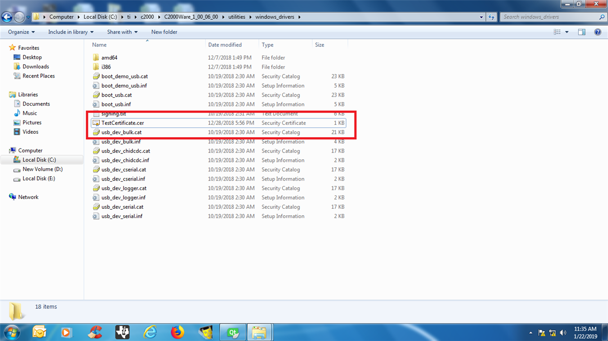

Sorry for the late reply.
Can i use the existing testcerificate (given with C2000ware) for updating the driver software??
regards,
Digvijay.
Hi Digvijay,
I didn't think C2000ware came with a test cert. What directory did you find this in?
I believe you're supposed to generate your own test certificate per the instructions: /cfs-file/__key/communityserver-discussions-components-files/171/signing.txt

What about the certificate??
Can i use the certificate shown in previous attached snap??
If i can use the the certificate mentioned above, how to install drivers??
DIGVIJAY
Respected sir,
Thank you for reply. As you mentioned
Sal Pezzino said:We do not provide the certificate. We do not release certificates in C2000Ware.
TI does not provide certificate. So the certificate in the below snap is the certificate generated by me(accidentaly as i dont know when it got generated).
So can I use the certificate in the below snap??
