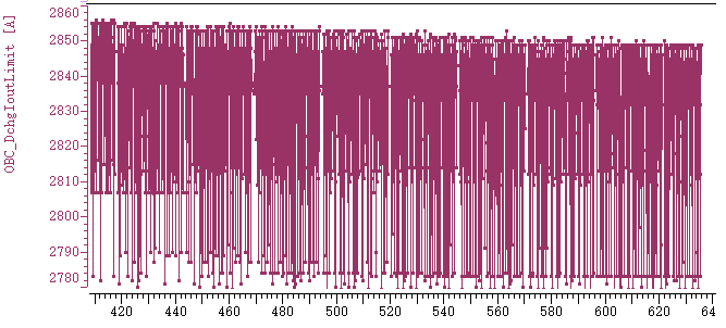

As above picture, SCO11 ADC convert result has ~60 fluctuation. It can not be resolved even enlarge ACQPS time.
It only has this problem on SOC11, which can't be reproduced if detect SOC11 input on other SOC.
Attach ADC code here, is there any suggestion for us trouble shooting in further? Thanks a lot.

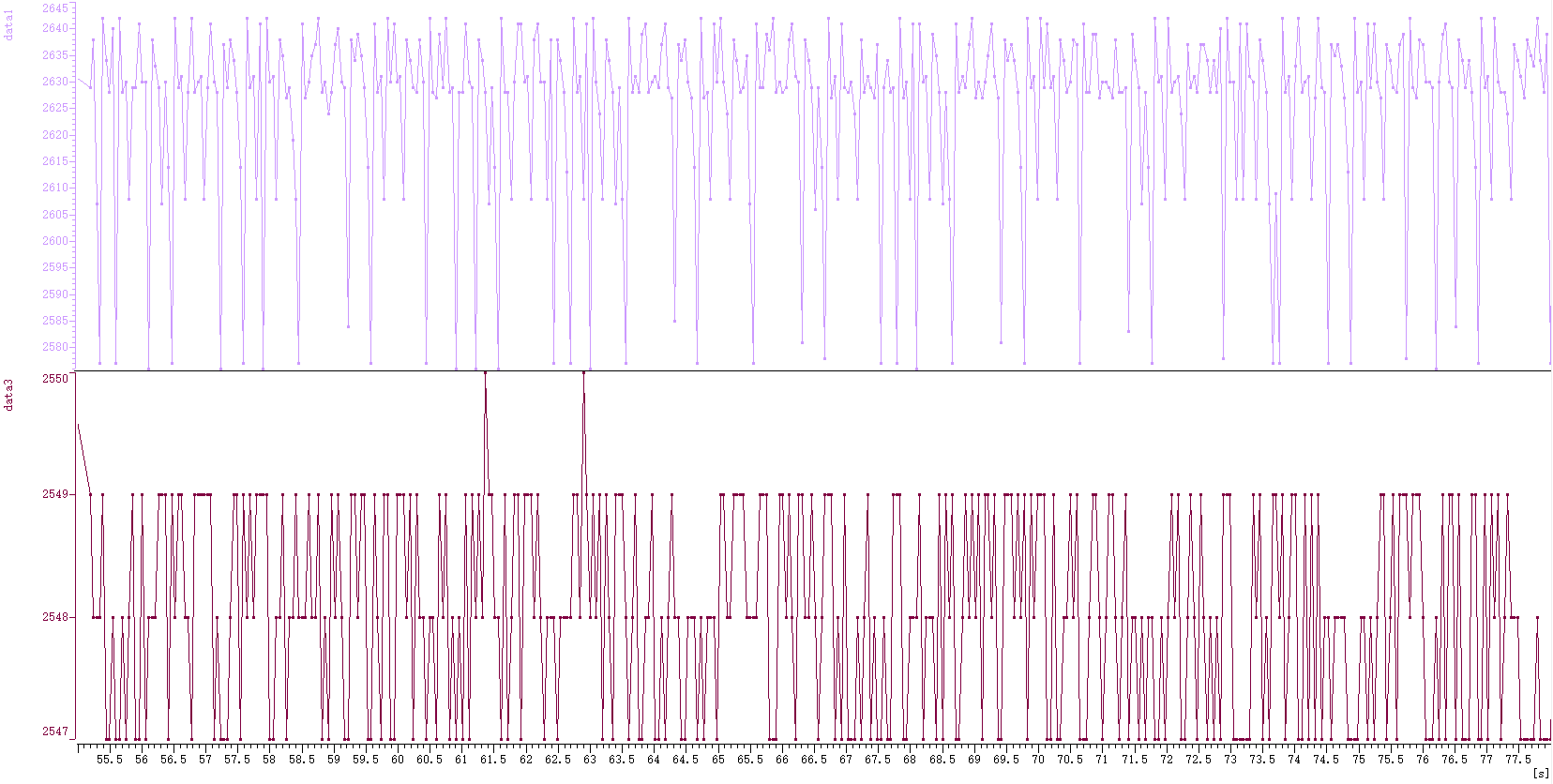

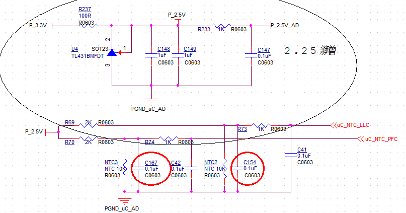

    By the way, here is SOC 11 sampling circuit, to detect NTC temperature. ADC reference is 2.5V.
    As below picture, both SOC11 and SOC15 are used to detect NTC temperature. Purple is SOC15 ADC conversion result, brown is SOC11.
    After switch SOC11 and SOC15 input, Purple is SOC11 ADC conversion result, brown is SOC15 result.
    As you see, the ADC jump value on SOC15 is usually below 10, but it's up to 50-70 at SOC11.

    Is there a circuitry difference between the NTC on B7 and B3? Is B7 connected to NTC_AMB (not shown in schematic snippet) and B3 connected to NTC_PFC (shown in schematic snippet)?
    Does slowing down the sampling interval improve the stability?
    Is A7 used for other conversions? Whenever A7 is sampled, the B7 S/H capacitor will also be connected to its pin so this can affect the recovery time of slow bandwidth signals.
    -Tommy
  • Hi Tommy,
    “Is there a circuitry difference between the NTC on B7 and B3? Is B7 connected to NTC_AMB (not shown in schematic snippet) and B3 connected to NTC_PFC (shown in schematic snippet)?”
    ---- You are right, B7 connected to NTC_AMB as the below shown, and B3 connected to NTC_PFC shown as above.

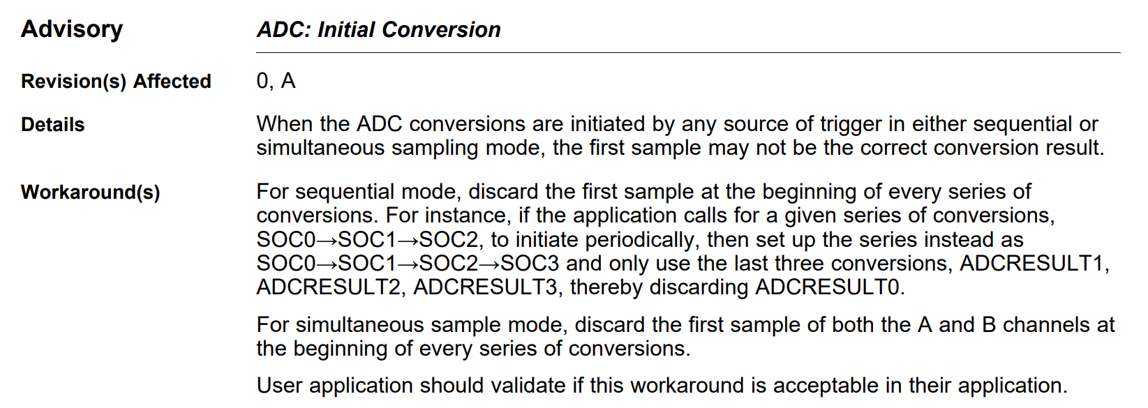

    With respect to the first sample, my original reply to Daniel was a request to confirm that all ADC advisories are handled correctly. There is an ADC first sample advisory in the errata that might explain the observations.
    -Tommy
  • Hi Tommy,
    Thanks for reminding, I have find the ADC advisory about this issue, is this the below one?
    - Rayna Wang
  • Yes, that is the Advisory that I was referencing.
