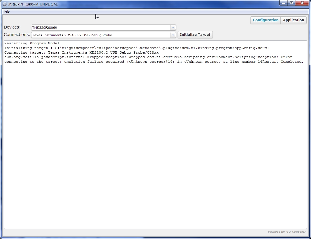

  • Dear Mark
    I'm sorry that I made some confusion.
    what I mean GUI composer is instaspinuniversalgui_v105 tools which is described at chapter 2,.1 of InstaSpin user guide(spruhj1g.pdf)
    I didn't know that GUI composer is a name for common tool to make GUI application.
    I think instaspinuniversalgui_v105 was implemented by GUI composer.
    I've got instaspinuniversalgui at following url
    http://www.ti.com/tool/INSTASPINUNIVERSALGUI
    running screen capture is as follows
    My actual question is that this instaspinuniveralgui could support our custom motor driver board, If I used XDS100v2.
    or it support TI development kits only ?
    please make me clear about it.
    Hae Ryong
  • I would think as long as you were using an XDS100v2 with your custom board it would still be able to connect and load the program? Are you using an XDS100v2?
    Whitney
  • I don't have XDS100v2.
    I'm wondering Instaspinuniversalgui tool is for your reference kit only.
    when I got confirmation that I can use instaspinuniversalgui with my custom board, then I will buy XDS100v2 for it
    Hae Ryong
  • I see. Yes, as long as you're using an XDS100v2, you can connect your custom board.
    Whitney
