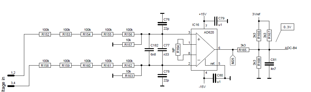

I am using F28069F microcontroller, with the customized board, I am facing problems with understanding the ADC module conversion.
I will post my findings, requesting to help me with this.
In the board I am using AD620 is used for the conversion.
I applied input voltage between the two terminals of the AD620, I have following output in the ADCRESULT register.

from the values obatined above I can see the variation of  approximate 30 decimal  increment\decrement in ADC result register value.

I have also attached the ADC circuit used for conversion.

    The F28069 ADC has an input conversion range from 0-3.3V or VREFLO-VREFHI depending on whether internal or external reference is mode is selected. Based on the annotation in your schematic, I will assume you are using external reference mode supplied at 3.0V for this response.
    The F28069 ADC is designed to convert 0V to 0LSB and VREFHI (3.0V in this case) to 4095. There will of course be error from offset, gain, and linearity that will have some impact on this, but for simplicity sake let's assume no error for now.
    If you want to utilize the full conversion range of the F28069 ADC, you will need to design your circuit so that your voltage range of your system input (presumably -20V to 20V) is scaled to 0-3.0V at the ADC-B4 ADC input.
    From your results it would appear that -20V/+20V is producing 1.377V/1.575V respectively at the F28069 ADC input. Can you confirm this by measuring the voltage at ADC-B4? If confirmed the issue is that your circuit is not generating the correct voltage on the ADC input. If you are measuring ~0V/~3V for -20V/+20V respectively then we will need to dig deeper to understand why the conversion result are not as expected.
