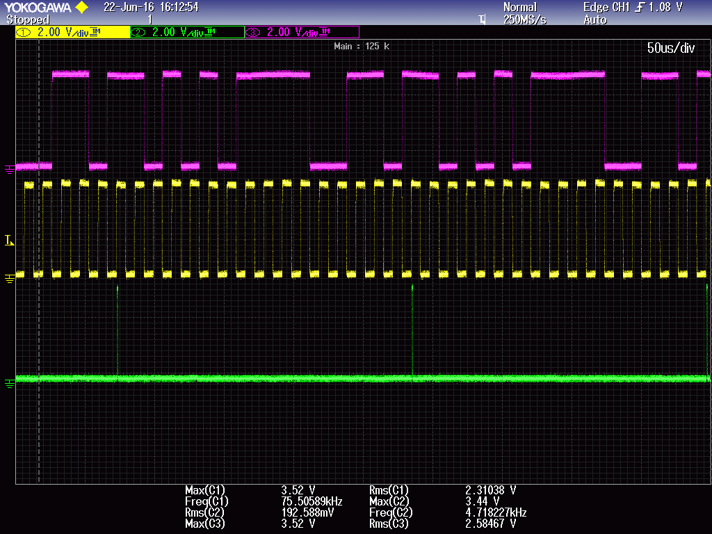

    Please find the attached screenshot.
    In the above screen:
    Yellow waveform : MOSI.
    Green waveform : SYSCLK  on the master side.
    Pink waveform : SPISTE pin output, which is connected to ground.
    Blue waveform : SYSCLK on the  slave side.
    Thanks in advance.
    Chetan.
  • Chetan,
    Does the data start out being shifted, or does the data become out of sync after some time?
    If the data starts out shifted, It sounds like there is an extra clock edge early before your master begins it's transmission.
    To be clear, the SPISTE on the Slave side is tied to ground? meaning that the pink signal is "SPISTE 'input'" instead of output? as I mentioned in my previous post. Tying the SPISTE to GND opens up your system to this sort of issue. Since the slave is always active, it will react to ANY transition on SPICLK, even noise. Please ensure that there are no unintentional transitions on SPICLK.
    -Mark

  • Chetan,
    It sounds like your Slave is detecting a transition on the clock line during initialization. Depending on the order of power up between master and slave. Your comments are incorrect for the Pull-up control. Setting GPxPUD to 1 will disable the pull-ups. It's up to you what mode you would like, but I just want to make sure that you may not be doing what you think you are.
    It also looks like you are reconfiguring GPIO58 to be EPWM7A after you already configure it to be GPIO mode.
    If you would like to use GPIO58 as a custom chip select, or Slave enable, the following strategy should help to guard the slave against any unintentional transitions on the SPICLK line.
    1. Master drive GPIO58 "active"
    2. Slave detect GPIO58 as active by polling, or by XINT
    3. Slave release SPI slave from reset.
    4. Master start transmission.
    5. Master end transmission.
    6. Master drive GPIO58 "inactive"
    7. Slave detects GPIO58 as inactive/
    8. Slave puts SPI into reset.
    -Mark

  • Chetan,
    This looks like it is the correct procedure. Please try it out and report back your results.
    I believe that the underlying issue probably that the default state of GPIO14( your SPICLK) is input with pullup enabled. If your SPI slave comes up before the master, it will see the SPICLK as High. When you reconfigure the master GPIOs to use SPI, and then enable the SPI module, SPICLK is driven to 0. since the SPI Slave is already enabled, it will act on this transition and clock in data.
    I think you are seeing how important the SPISTE signal is for the SPI module. You are relying on a software workaround to handle what is done in hardware. If you have the chance to revise your board, I strongly suggest bringing out the SPISTEB on the slave side to a pin as it will free up some software complexity and delays.
    Mark

  • Hello Mark,
    I was able to get the waveforms for the GPIO58 has it was discussed earlier. But I am still getting error in my data received in the slave.
    Please find the attached screen for the same.
    Green : GPIO58(SPISTE)
    Yellow : SYSCLK.
    Pink : MOSI.
    In the screen below, data sent is (0xABCD) from master on the falling edge of the sysclk.
    Data sent matches the waveform of MOSI.
    Please do let me know if anything has to be checked or changed.

  • Chetan,
    Can you try to provide a delay in between each transmission and see if that helps?
    -Mark
