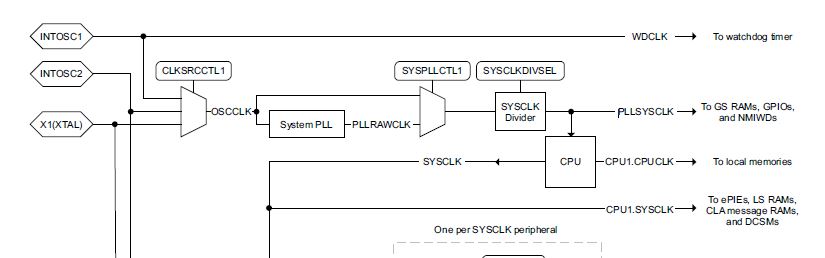

Dear Sir/Ma'am,
I have written c code to check the SYSCLK frequency.
It has the following code:
// This should generate 200KHz SYSCLK from 10MHz oscillator using the PLL multipliers. --> 10*(1/50)MHz --> 5 microseconds.
ClkCfgRegs.CLKSRCCTL1.bit.OSCCLKSRCSEL = 0x0;
ClkCfgRegs.SYSPLLMULT.bit.IMULT = 1;
ClkCfgRegs.SYSPLLMULT.bit.FMULT = 0;
ClkCfgRegs.SYSCLKDIVSEL.bit.PLLSYSCLKDIV =50;
ClkCfgRegs.SYSPLLCTL1.bit.PLLCLKEN = 1;
Further, I have configured Timer-1 and toggled a GPIO to measure this frequency. My timer period is 10000. So, I need to get 5us*10000 = 0.05seconds on the CRO.
But, I get a waveform whose frequency is scaled by a factor 4 (measured time: 2s). I tried checking all the related pre-scalars but couldn't find where the extra factor 4 is coming from.
Can someone please help me with this?
Also, what is the relation between the PLLSYSCLK and SYSCLK (CPU). I suspect that factor is in here. But, I can't find from the manuals.

  • Subrahmanyam,
    Ratio between SYSCLK and PLLSYSCLK depends on PLLSYSCLKDIV configuration. Based on clock configuration, you need to calculate the SYSCLK frq. You are using value for IMULT '1' which is not correct. It's out of PLL spec (supported output frq). In this case you don't need to lock the PLL (use bypass mode, don't  set PLLCLKEN to '1') and try running the test.

    Question-1:
    as per the above diagram, I could not properly understand the relation between SYSCLK and PLLSYSCLK as PLLSYSCLKDIV comes after OSCCLK.
    Else, If my PLLSYSCLK = 200MHz and PLLSYSCLKDIV = 2, does it mean that SYSCLK = PLLSYSCLK /PLLSYSCLKDIV ? Because, from the figure, it doesn't reflect that!
    Yes, SYSCLK = PLLSYSCLK /PLLSYSCLKDIV.
