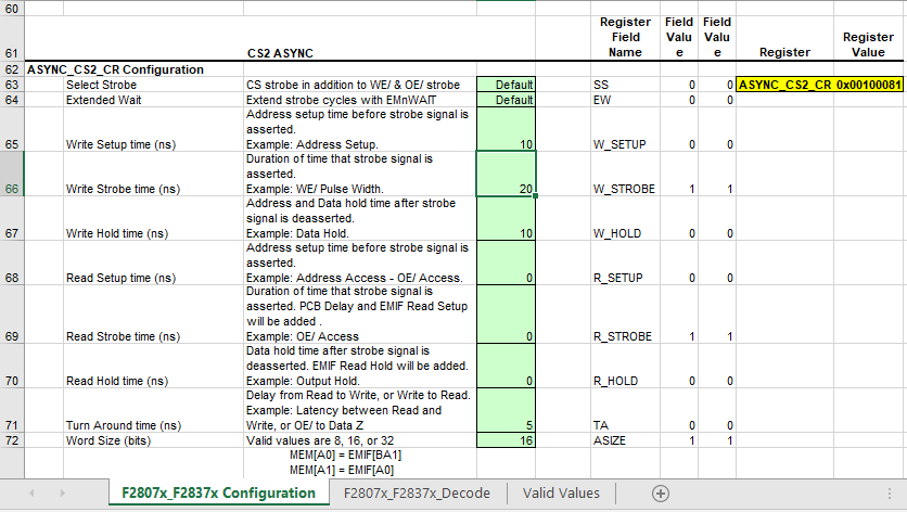

I am having issues connecting the EMIF of F28379D to Xilinx FPGA.

//Configure the access timing for CS2 space
Emif1Regs.ASYNC_CS2_CR.all = ( EMIF_ASYNC_ASIZE_16 | // 16Bit Memory Interface
EMIF_ASYNC_TA_1 | // Turn Around time of 2 Emif Clock
EMIF_ASYNC_RHOLD_1 | // Read Hold time of 1 Emif Clock
EMIF_ASYNC_RSTROBE_4 | // Read Strobe time of 4 Emif Clock
EMIF_ASYNC_RSETUP_1 | // Read Setup time of 1 Emif Clock
EMIF_ASYNC_WHOLD_1 | // Write Hold time of 1 Emif Clock
EMIF_ASYNC_WSTROBE_4 | // Write Strobe time of 1 Emif Clock
EMIF_ASYNC_WSETUP_1 | // Write Setup time of 1 Emif Clock
EMIF_ASYNC_EW_DISABLE | // Extended Wait Disable.
EMIF_ASYNC_SS_DISABLE // Strobe Select Mode Disable.
DUTY = (long *)CS2_START_ADDRESS;
*DUTY = 0x35;
while (1);
when I run it and look at memory address 0x10 0000, all I see is 1000 regardless of the data. I tried to CS2n pin to FPGA to see if I had loading issues but it hasnt worked.
