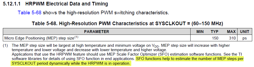

  • Dmitry,
    I'm told that it might be possible to use the HRPWM MEP scale factor to identify clock shifts. The HRPWM step sizes are determined independently of SYSCLK so it can act as a reference point. I am not very familiar with HRPWM usage so you will need to start a new thread for further discussion on this.
    -Tommy
