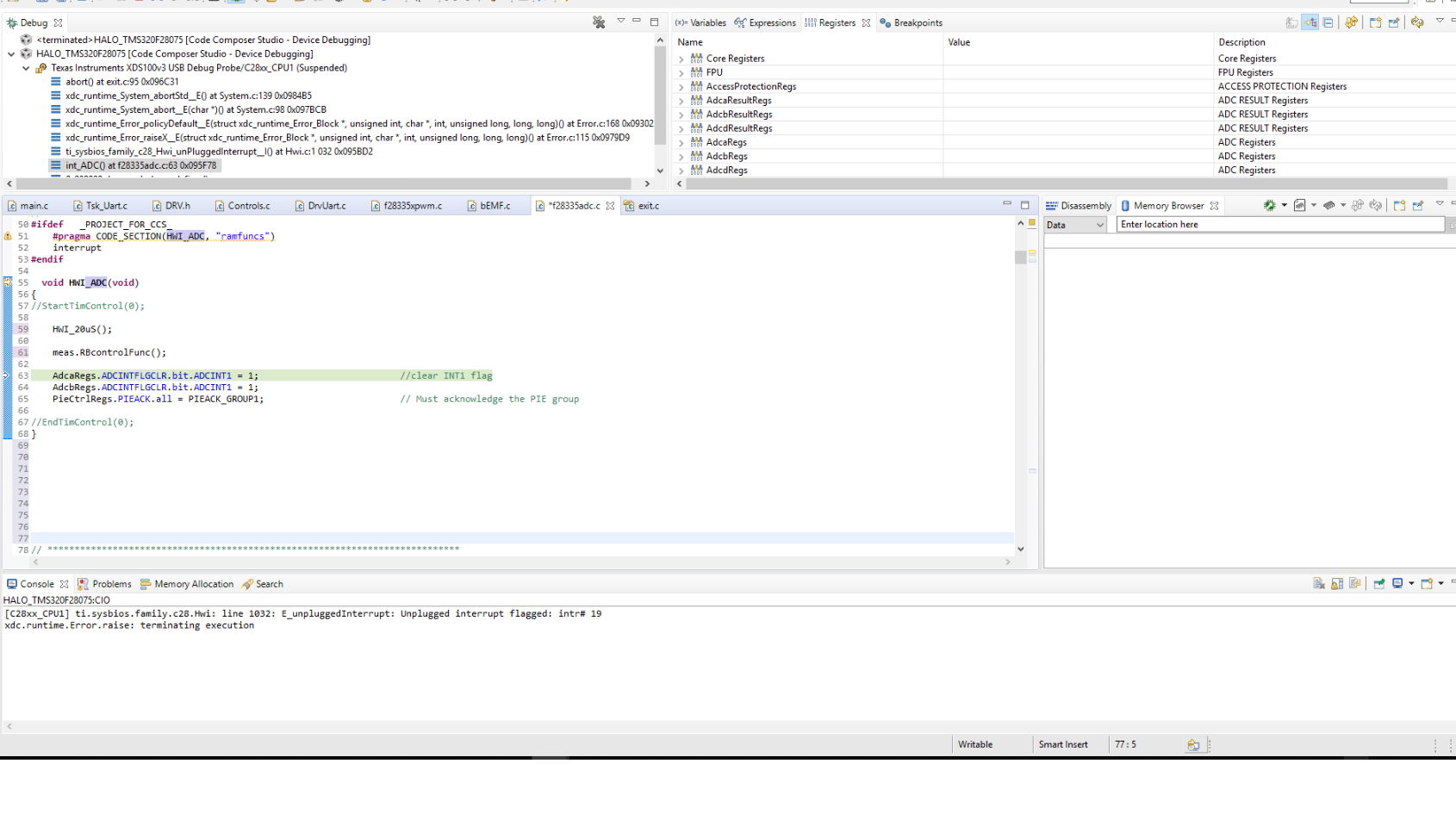

Hi TI!
Help me please with my issue.
Why interrupt instruction is not available?
I have interrupt from my ADC A and B ? they have address of function HWI_ADC.
Can i define same function for ADC A and ADC B interrupt? And why i have problem with this interrupt.
Start of ADC convention selected by EPWM4 , it works like a timer.
  • The interrupt #19 mentioned in the error message is caused by an ITRAP (illegal instruction). Judging by your screenshot, I think you're getting into the Hwi just fine, but then getting an error when calling meas.RBcontrolFunc().
    Can you confirm that meas.RMcontrolFunc() is valid? Can you place a breakpoint and step into it? Is its address correct? If you look at it in the Memory Browser or Disassembly window, is the code there in memory?
    Whitney
  • Hi, i have fault after initialization adc,  meas.func is ok, name of function modify for screenshot.
    May be i have problem with interrupt epwm?
    If i set for start adc -epwm4a i have that problem.
    I think  problem because instruction interrupt is not valid , in examples werd interrupt have another colour.
    programm dont come to interrupt function hwi_adc, after set adc and epwm - fault
  • after set epwm4 i have foult

  • I was right , all interrupt instructions are not available in all project , from ti drivers to my code.
    Because when i set declaretion interrupt instruction in c files from ti(drivers) it recconect me to my code where pragma hwi_adc - it really strage .
    Could you help me to set on that instruction.
  • Thanks for your patience. One thing I noted in your screenshot--you don't need to use the interrupt keyword on ISRs managed by the Hwi. The Hwi dispatcher will do the context save for your so it's unnecessary.
    Since you are putting your ISRs in ramfuncs, have you remembered to add code to copy the ramfuncs from flash to RAM at the start of the program?
    Whitney
  • Hi, yes i copy rumfunc to ram.
    I think i found problem, my iq math function mpy  have copy in rumfunc but when i call that function with argument 5000 mpy 0, i have not result  0 . Can you help me debug that problem.
