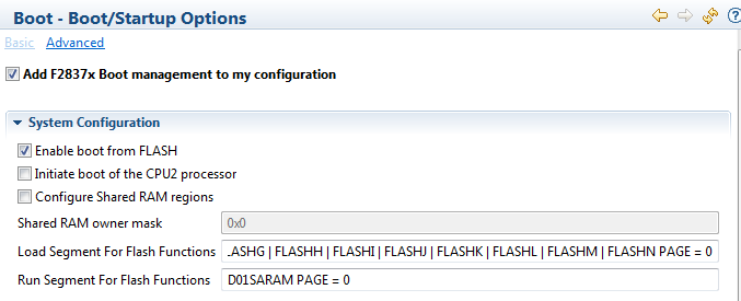

I am using TI-RTOS version tirtos_c2000_setupwin32_2_16_01_14 on TMS320F28075 microcontroller.  I am facing issue to boot the application from flash on this RTOS. My application is not getting boot from flash after power cycle to board. I have enable the option "Boot from FLASH " in RTOS configuration  file. Please let me know ,if  I need to do some additional settings in configuration file.

  • Hi Atul,
    Are you disabling the watchdog in your application? CCS generally does this for you (via a gel file setting) when you load a device. Note: you can use the reset function in the kernel to do things like this. For example, you could have the following in the .cfg file.
    var Startup = xdc.useModule('xdc.runtime.Startup');
    Startup.resetFxn = "&myResetFunction";
    And then in myResetFunction, add the code to disable the WDT. Please note, there are restrictions on the things you can do in this function since it is called so early in the boot (e.g. no stack yet and .cinit records has not been initialized).

  • Hi Todd,
    My application is now working from flash. I have disabled the watchdog timer from RTOS configuration file. I think by default watchdog timer is enable so my application was getting reset. Now it is working fine.

  • Atul,
    Yes, by default watchdog is enable in hardware. When connected to emulator, CCS Gel file disables the watchdog. In standalone, application need to disable the same if not used.
