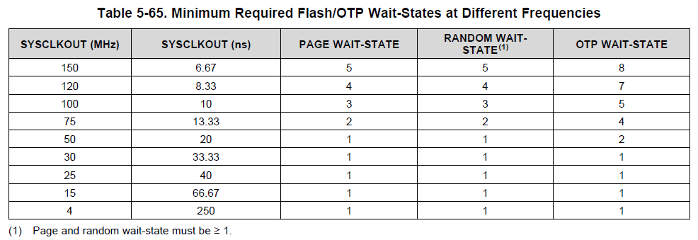

    Also, could you verify that your flash wait-states are set properly according to the table below (FBANKWAIT register)?

    The waitstates only affect flash reading, so this shouldn't actually be a concern. My mistake.
