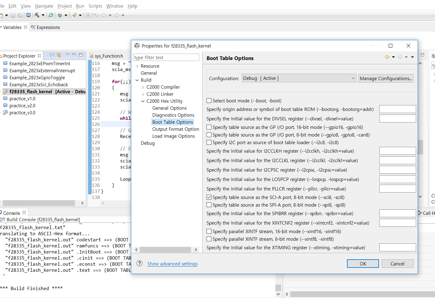

The photo below is the issue I have faced and I am unable to solve it out.
It just stopped and didn't run next step.
I am guessing I put the wrong argument onto command argument inbox that can be found at “debugging tag” of Serial flash programmer property. The line below is the argument I gave.
-d f2802x
-k C:\ti\c2000\C2000Ware_1_00_06_00\device_support\f2833x\examples\f28335_flash_kernel\Debug\f28335_flash_kernel.txt
–a E:\CCS_Project\practice_v3.0\Debug\practice_v3.0.txt
-p COM4
-b 9600
The reason I did those things above is because I referred the line 6 and 7 of “6.2.2 Building serial_flash_programmer in Visual Studio” in the document “Serial Flash Programming of C2000™ Microcontrollers“.
As the document I have mentioned above explains how to convert the .out file to .hex file at “6.1.1 Kernels” in the document, I followed it in uncertainty.
I enabled the hex2000 utility for f28335 flash kernel example in CCS and set my project property as below with a hope that I did well to produce the hex file required for SCI boot loader.
It is said the format must be in the ASCII SCI boot format, which is why I check the square boxes as the photos above.
I gave the same options to my project targeted to be load in FLASH RAM.
After the setting above from hex2000 utility, I could see .hex file. I changed the .hex extension to .txt because of the description of “6.1.1 kernels” section. “f28335_flash_kernel.txt and “practice_v3.0.txt” are the extension modified files I got after build process.
