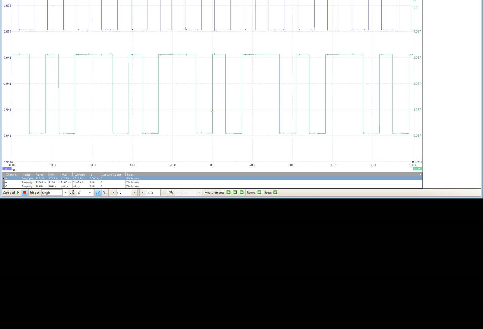

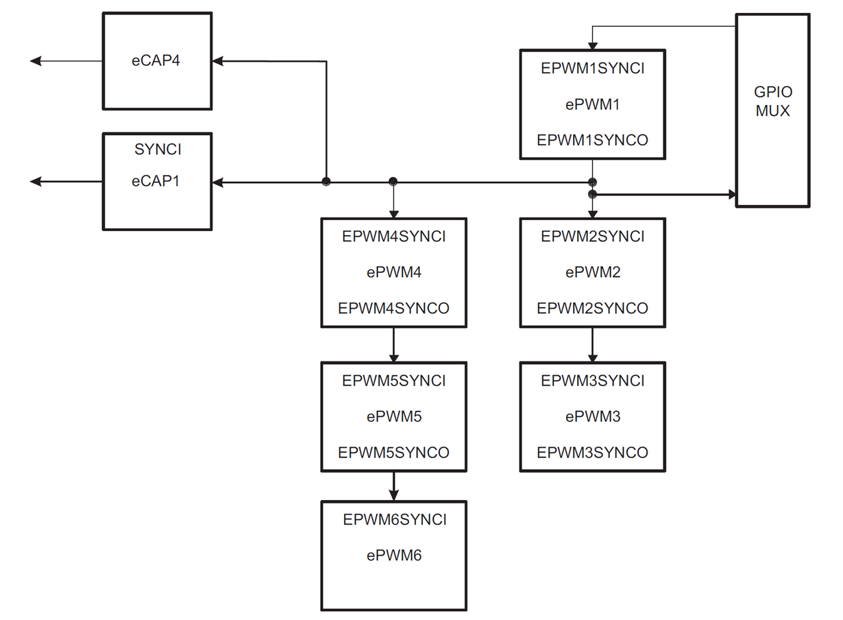

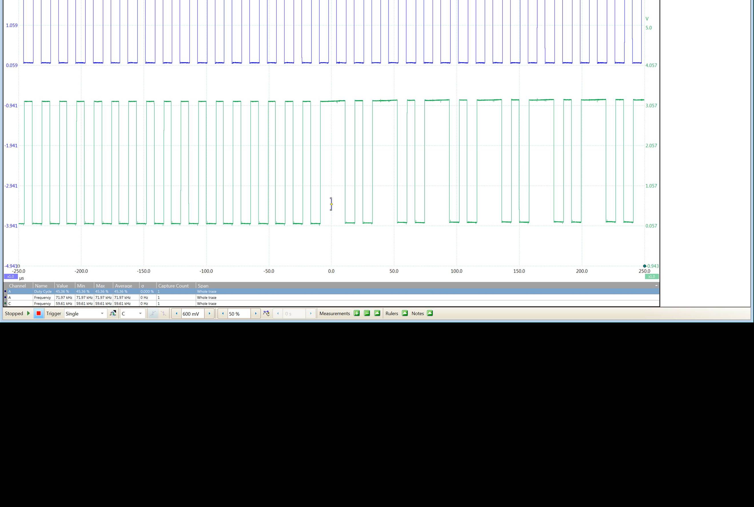

My customer has had his PWM modules linked together with the SYNC output of PWM1 provided to PWM2 – PWM6 through the master/slave PWM module configuration options. He is trying to break the link between modules 2 & 3 so that he can have the following daisy chains:
  • PWM1 -> PWM2
  • PWM3 -> PWM4 -> PWM5 -> PWM6
When customer tried setting EPwm3Regs.TBCTL.bit.PHSEN = TB_DISABLE he found that the CTR would pause at one count for a period of time on both the count up and count down. This is all using Matlab Simulink auto-generated code that is pulling in a custom C module to help with the configuration of the PWM. The PWM is also triggering an ISR that is used for calculation of all of the control code. There is some issue with the way that it is configured that is preventing him from achieving good operation when he does not link all the PWMs as a slave to PWM1.
See figure 51 - here: http://www.ti.com/lit/ug/sprug04a/sprug04a.pdf
Your inputs would be greatly appreciated.

  • Viktorija,
    There should be no issue with separating the ePWM sync chain into two time domains.
    Can you provide more details here?
    1. How long did it pause?
    2. What were the counter values?
    3. What PWMs experienced this phenomena?
    4. Is the customer preforming any on-the-fly changes to the PWM?
    5. Does this only happen once, or does this happen every period?
    6. How is the customer detecting that the TBCTR has stopped?

  • Cody,
    Here are details from customer:
    I finally was able to reproduce a problem(s) that we need to resolve with the PWM modulators written with purely C code. There are two problems that I can replicate in C code, as well as model-based. I apologize for the length of this e-mail, but it is very important to communicate the issue(s) so that they can be understood and addressed.
    First, our objective is to have:
    1. ePWM1 and ePWM2
      1. Run at 24kHz
      2. Phase synchronized at startup with 0 degree phase shift
      3. Center-aligned, interleaved modulation, i.e., Up/Down counter.
    1. ePWM3 and ePWM4
      1. Run at 72kHz
      3. Constant 50% modulation
    1. ePWM5 and ePWM6
      1. Run at 72kHz
      2. Phase synchronized at 180 degrees with respect to ePWM3 and ePWM4 at startup
      4. Variable phase shift with respect to ePWM3 and ePWM4 while operating
    Here’s how I have setup the PWM modulators:
    Active Front End (ePWM1 and ePWM2):
    1. Frequency is 24kHz with an every 3rd event SOCA (Start of Conversion for ADCs) and ePWM1 interrupt, i.e., EPwm1Regs.ETPS.1bit.INTPRD = ET_3RD
    2. Uses an Up/Down counter for center-aligned interleaved modulation, i.e., EPwm1Regs.TBCTL.bit.CTRMODE = TB_COUNT_UPDOWN
    3. Phase Enabled for startup synchronization, so the PHSEN bit is set for both with a phase offset of zero, i.e., EPwm1Regs.TBPHS.half.TBPHS = 0.
    Here is my code for initialization of ePWM1 and ePWM2 to achieve the above results:

    With the above code, there is no phase synchronization between ePWM3/ePWM4 and ePWM5/ePWM6 unless the EPwm2Regs.TBCTL.bit.SYNCOSEL bit is set to 0. When I do this and add frequency dither to ePWM1 and ePWM2 by manipulating the EPwm1Regs.TBPRD value then the dither continues to the ePWM3 through ePWM6 modules. Since they are running at different frequencies, the dither represents a significantly different % change in frequency between ePWM1/ePWM2 (24kHz) and ePWM3/ePWM4/ePWM5/ePWM6 (72kHz). Thus the need for EPwm2Regs.TBCTL.bit.SYNCOSEL to be set to 3 so as not to synchronize across these different frequency domains.
    All of the above explains our primary and most urgent problem. The second problem is that if you change the DabPwmFrequency to 68000 from 72000, the modulators exhibit odd behavior and you can occasionally capture frequency and/or duty cycle changes that happen rare enough that if you didn’t pay close attention, you would not see them. The severity of these changes appears to be related to particular frequencies defined by the DabPwmFrequency setting, i.e., some frequency are worse than others. It is our view that ANY frequency should work in the prescribed manner, i.e., 50% duty cycle at the frequency determined by DabPwmFrequency. I have captured this behavior on a scope and inserted it below. I have included both expected and unexpected modulator output.
    Normal and expected results when ePWM1 and ePWM2 are running at 24kHz and ePWM3 – ePWM6 are running at 72kHz can be seen with phase shift in the attached movie file 20190607_155713.mp4. Just for reference, I have also attached what happens to the phase shifting when I disconnect the sync output from module ePWM2 to 3 to allow for independent operation of ePWM1/ePWM2 from ePWM3/4/5/6 in file 20190607_160114.mp4. In all examples below the EPwm2Regs.TBCTL.bit.SYNCOSEL bit is set in order to achieve controllable phase shifting between modules ePWM3/ePWM4 with respect to ePWM5/ePWM6.
    Unexpected Result: ePWM5A as observed on the EZDSP Development Kit (Pin 30 of P8) changes frequency and duty cycle.
    Another scope shot showing an unexpected result – there are subtle variations in ePWM3A (pin 13 of P8 on the EZDSP dev board) and large and erratic changes on ePWM5A (pin 30 of P8):
    Any suggestions to resolving this problem would be greatly appreciated.

  • Viktorija,
    there was a lot of information in there, so if I did not address a question please let me know.
    While the above quote it true, it is not clear in reference to your issue. It is true that you can split the ePWM sync chain into different time domains. However, on F28335 you cannot directly synchronize PWMS 3 and 4 without PWM 1. Please see the following sync chain diagram. PWM3 sync out does not connect to PWM4 sync in.
    The only way to synchronize PWMs 3 and 4 is to synchronize them both to PWM1. The customer will need to evaluate keeping the PWMs synchronized to ePWM1 if this is not acceptable then the may have to rework hardware. One option would be to connect PWMs 1, 4, 5, and 6 for their 72KHz signals and PWMs 2 and 3 for their slower 24KHz signals. Note: if they did go with this configuration the could not sync the 24KHz and 72KHz domains on a cycle-by-cycle basis(the could preform a sync at the beginning though)
    For the second issue its a some what unclear which signal the customer is referencing. If it is the purple signal then this may be caused by the incidental re-syncing to PWM1 expanding or reducing the high or low times. If they are referencing the green signal: that appears to be a major issue that would need more investigation. Off of the top of my head it looks like you are possibly missing a compare value... Is the customer correctly using shadow loading?
    Cody
  • Cody,
    Per customer:
    The internal connections between the ePWM modules described and outlined below is surprising. Is this elaborated upon anywhere in the ePWM Technical Reference?
    This is a problem for us and we will likely have to re-orient the modules in hardware to fully accomplish our functional objectives.
    Viktorija
  • Viktorija,
    this is documented in the Data Sheet so that a customer will identify this issue early on when assessing the device. The thinking is any information that is required for "High Level" system planning should included in the datasheet.
    The synchronization chain is discussed in the ePWM Reference Guide, but the exact connections are not detailed.
    Is there some misleading information in the documentation which caused the customer believe that the ePWM modules are connected in another way?
    Does the Customer need to maintain a cycle-by-cycle synchronization? If the customer plans to keep the period and phase offset constant between ePWMs 3,4,5, and 6 then they might be able to get away with sync'ing their higher speed PWMs to ePWM 0 at initialization. After initialization the can disable the sync chain for ePWMs 3,4,5, and 6. This will establish a set phase relationship between them, and will keep the dithering of ePWM1 from affecting them.

    I understand and appreciate that it is covered on the datasheet with a diagram. However, we all know that nobody goes to the datasheet to get detailed application programming information. IMHO, this should have been covered in a very detailed manner within the ePWM Tech Ref. It is not and it has cost us time. It’s a bit disappointing.
    Please consider adding this info into ePWM Tech Reference document as well.
    Viktorija
  • Victorija,
    I agree with the customer that this information should be included in the Tech Ref., I was a little surprised when I didn't see it on first glance.
    If fact this information is actually also in the ePWM's User's Guide, Please see Figure 9.
