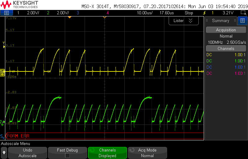

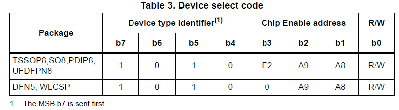

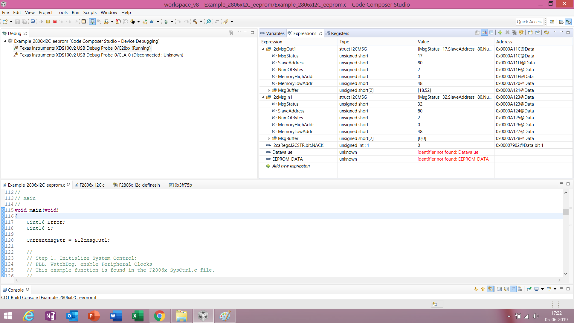

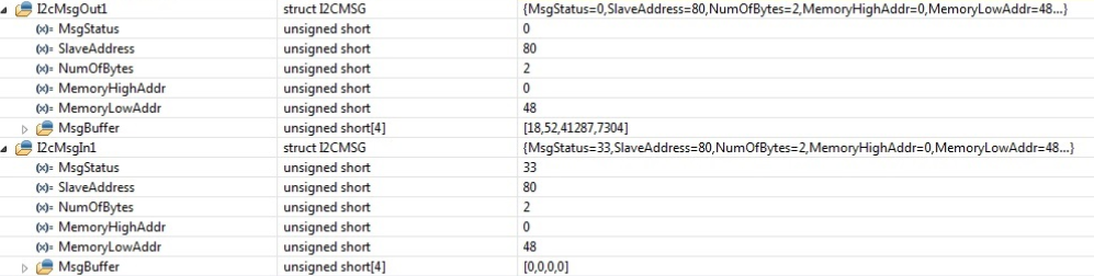

  • Kevin,
    I have tried today by interfacing external eeprom 24C08WP (from STM) which is an 8 Kb eeprom. I have imported the code i2c eeprom and trying to run. Again I am unable to read the data. I am just using sample code, not made any changes. for I2cmsgOut1 I am receiving 0 status and some times I receive 17 status, but both the times I have not received the data..
    I have attached the screenshots of both the conditions. I am getting NACK bit as 0. I have tried by using 3.3k resistors and 10nF cap. Also tried by using 4K7 resistor and 1nF cap for EEPROM hardware connections.I have attached my code here with.  Please tell me, what is going wrong or send any working code.

    Additionally I want to ask is there any issue withe the slave address, High address and low address. I to decide all these parameters. In the datasheet of EEPROM they have not given such things.
    Thanks & Regards,
    Nisha
  • Nisha,
    The slave address for this device follows the bellow format from the 24C08WP datasheet. I'm not sure what A9/A8 bits are supposed to represent, you may need to ask the STM team.
    The 24C08WP device uses only one Byte address, not both a High and Low byte. The data format should follow the below (once again from the 24C08WP device datasheet):
    You'll need to edit the default i2c_eeprom code to match this data format.
    Kevin
  • Kevin,
    I have tried giving device address and memory addresses as per STM eeprom, but that is not working. I am receiving waveforms on I2C pins as I attached in above reply, but unable to read the data from eeprom. Today I have tried by using Atmel's eeprom 24c02 and run the sample code given in c2000ware, did not get any read. I have also tried by using  the following codes, still not receiving any data. I have read so many threads, how is it possible that the people had run the same code for the same MCU and same eeprom which I am using and they got results, and I am not receiving any data. What is the actual reason. I am just trying to read and write a single byte, still not working. Till now I have tried three eeprom ICs. I kindly request you please tell me the reason or suggest the necessary changes in the code or send the whole working code instead of sending read write functions only.
    Nisha

  • Nisha,
    From your previous scope screen captures it looks like the rise times being experienced on the bus are quite long and may be out of the I2C spec. This might be due to the pull-up resistance or capacitance on the bus and they may need to be tweaked. I'd also suggest making sure the internal pull-ups of the C2000 device are disabled.
    There's likely a good reason you aren't able to communicate with your epprom device successfully, which you'll need to investigate further by scoping the bus and checking the data that's being sent back and forth. Check that ACKs are being received/sent or investigate why a NACK is being recieved/sent. We don't typically review all of the user's code or provide full software applications specific to the user's usecase on this forum. You'll have to do this work on your own.
    You may have better luck utilizing the functions I provided in this prior E2E post rather than the i2c_eeprom example on C2000ware:
    https://e2e.ti.com/support/microcontrollers/c2000/f/171/t/773846
    This SW is for F2802x, but the functions should be able to be used or easily ported to your F2806x device.
    Kevin
