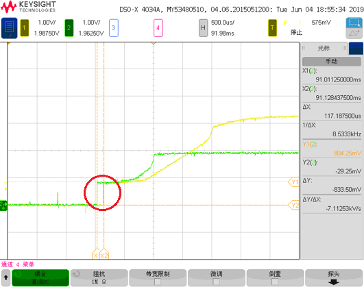

If the power-on sequence is wrong, will it cause the boot pin level to be indeterminate? DSP can't enter flash operation normally? Will the DSP be damaged if the power-up sequence is not correct for a long time?Can the power-on sequence of the drawing be ok? Yellow is 3.3V, green is 1.9V.
    I see that both supplies are ramping together, which is per the datasheet guideline. However, I don’t understand how both supplies rise to 833 mV almost instantaneously (inside the red circle)
