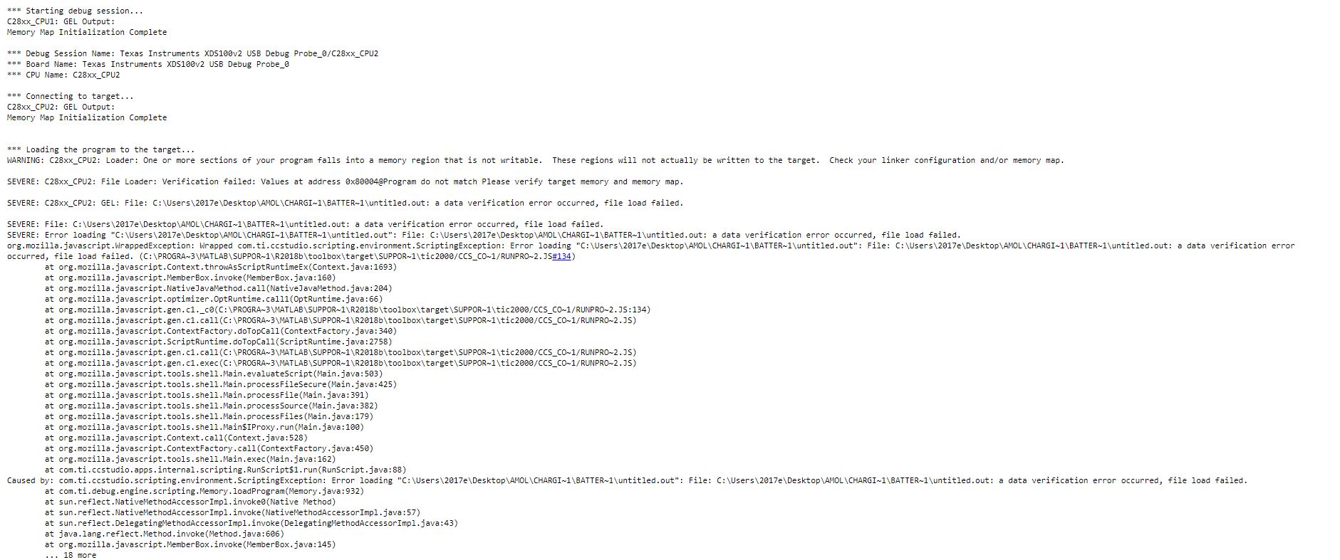

I have purchased some new boards of TI TMS320F28379d and facing some issues while dumping code or running it in external mode using MATLAB / Simulink. Older boards are working fine with the same configuration settings. I am attaching the returned error and warning in the Simulink Diagnostic Viewer. Please if somebody can help me out with this.

This looks like a configuration error -Embedded Coder is trying to write code into a region which is not allowed on F28379D (but which may work on other chips). I'd suggest starting with one of the F28379D examples we ship, and copy-paste your model into that.
Also try this link: Troubleshooting_Guide_for_ExternalMode_TIC2000.docx

Thanks for the reply Sir. I have tried that with the available examples for this particular board. However, getting the same error.
Not sure about the issue then - the shipping examples work on my F28379D LaunchPad.
I do see you are using R2018b, but pointing to a R2017a directory. Not sure why that is; but you may wish to check.
