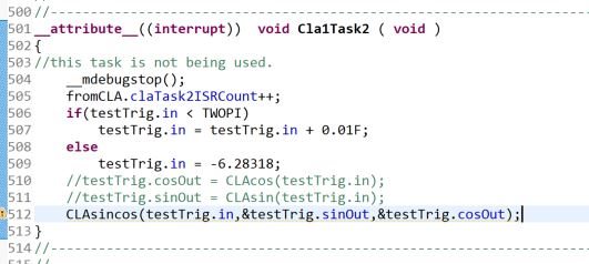

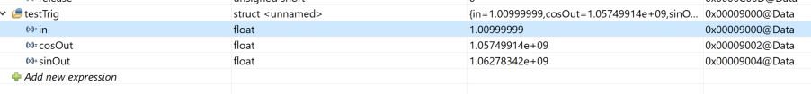

CLACos() and CLASin() functions are both returning results along the line of +-1.0e+9.  The values do change slightly depending on the input but a stay in the same order of magnitude for all inputs -2pi to +2pi.
I'm assuming I don't have something loaded correctly.

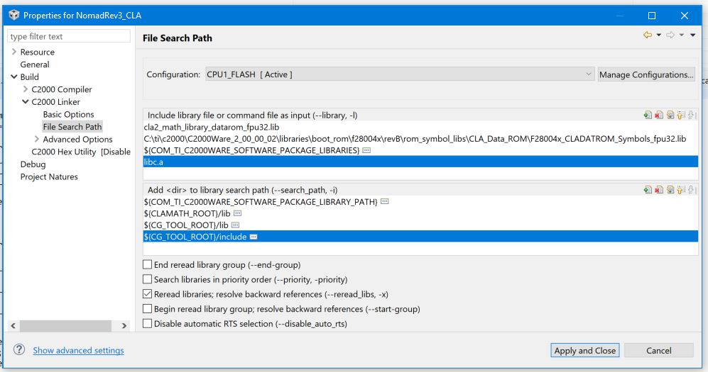

The CLAcos/sin location along with the tables are shown below from the .map file:
And here is the search path:
not sure what I am overlooking.

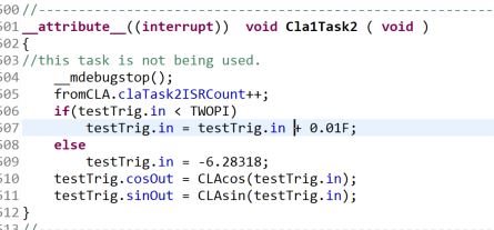

  • Here is the code snippet that is running in CLATask2.  Task 2 is triggered in c2000 software at 1kHz.

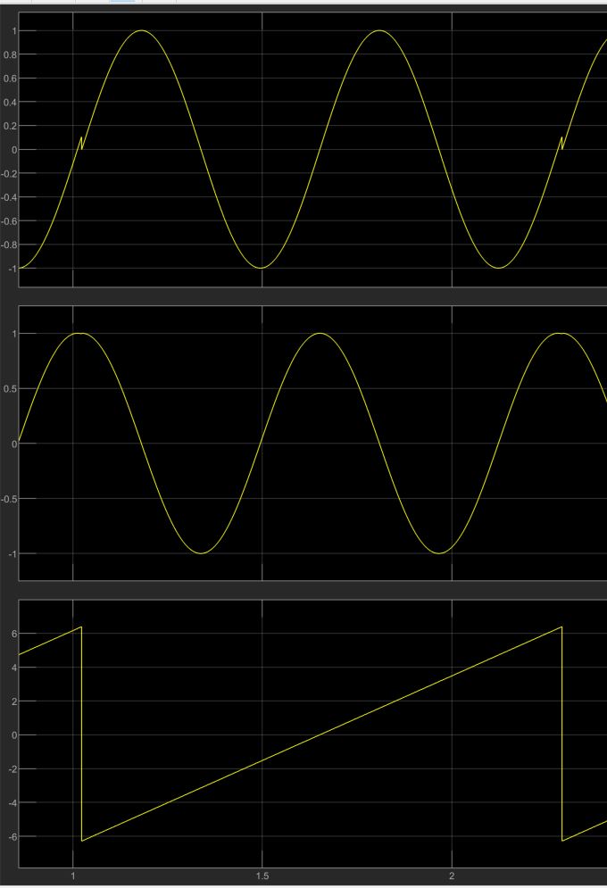

    And a plot of the results:
  • FWIW the CLAsincos() function works as expected.
    generates this output:

    Have you tried running the C2000Ware example for CLACos on the F28004x?  There is a FLASH build configuration as well as a RAM build configuration.  Comparing this to your implementation would provide clues as to where things have gone wrong.
    C:\ti\c2000\C2000Ware_<version>\libraries\math\CLAmath\c28\examples\cos

    Since the CLAsincos() function works in my firmware this has lost a bit of urgency.  I did confirm the example CLAcos() function provided works as expected running from RAM or FLASH.  There are a number of differences in the xx_lnk.cmd files in need to sort through (this project is based on an example from an earlier revision of  C2000Ware), I just haven't had time.
    Given that I have a project that works as expected I should be able to track down the problem.  Thanks for your help.
