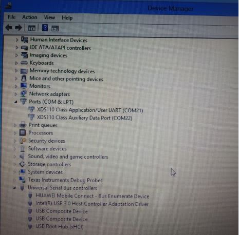

Can any one help that why this error comes while programming flash of TMS320F2812 by uniflash and XDS110 debug probe and how to resolve it: -
After I tried to update firmware xdsdfu-e exe but it gives errror as found 0 devices even though in device manager of system XDS110 detected. So How I can resolves this issues?
    The error -260 is covered in detail in the Debugging JTAG page below: (search for the error number)
    http://software-dl.ti.com/ccs/esd/documents/ccs_debugging_jtag_connectivity_issues.html
    That said, the root cause for the debug probe not being accessible may be due to it being locked by another application. In other words, make sure that CCS and Uniflash are not running at the same time (it seems you have both installed) and, if this is the case, try to unplug and re-plug the Debug Probe (or even plug to a different USB port), since a process may be hijacking your XDS110 and consequently preventing it from being visible by another application.
    Hope this helps,
    Rafael
