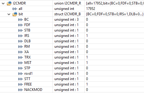

I have attached the I2CMDR register settings before and after sending i2c data.
Before-> After->

  • Your FIFO setup seems okay. As you step through your writes to I2CDXR, do you see the FIFO level status in I2CFFTX increasing? After you run the rest of the code, do you see it go back to 0? What about I2CCNT? Does it return to 0 after you run the code?
    Whitney
  • Yes the TXFFST in I2CFFTX increases to 3 as I step through I2CDXR writes. I2CCNT goes to 3 too. But both the registers stay at 3 even after i2c start send "I2caRegs.I2CMDR.bit.STT = 1;".
    I2CFFTX status-->
    I2CSTR status-->

    status register is as follows:
    Karthik
  • Have you seen your DAC ACK that it has recognized its address? If you look at the SDA signal, can you actually see an ACK? It looks like the NACK bit is just continuously being set so the C28 I2C won't even try to send the data.
    Are you confident your slave device is working and that you're meeting its requirements (correct address, correct clock speed, etc...)?
    Whitney
  • Yes I resolved the issue the DAC ACK is not received due to a digital isolator in between. This hardware setup worked without any issues with M3, and the c28 do not send the next byte without ACK. Is there any way for my C28 to ignore the ACK bit and continue sending the data bytes?
