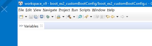

Finally can UniFlash be used for this?
If so is the menu shown in the attached image the correct location to do so?

    I do not have a "tools" menu in the editor perspective.  In the debug perspective there is a tools menu but i do not see a flash GUI entry. (see attached) Where else should I look?
    To use the FLASH API i would need to write a stand alone application to write these two registers?
    I will need the addresses of the registers in order to use the FLASH API.  I have searched the data sheet for the processor, the TRM, the training module, the boot_ex2_customBootConfog example project and so far have only found the starting location for this memory region, not details of the register location.    Can you tell me where this information is documented?

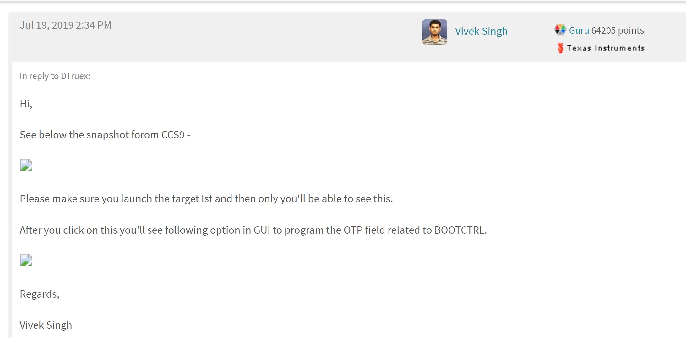

    See below the snapshot forom CCS9 -
    Please make sure you launch the target Ist and then only you'll be able to see this.
    After you click on this you'll see following option in GUI to program the OTP field related to BOOTCTRL.
    Vivek Singh
  • The images are not displaying:
  • Don,
    You are on the right track.  All you need to do is to look at the Tool pull down options with  F28004x connected.  You will then be able to open the On-Chip Flash interface.
    Krishna
