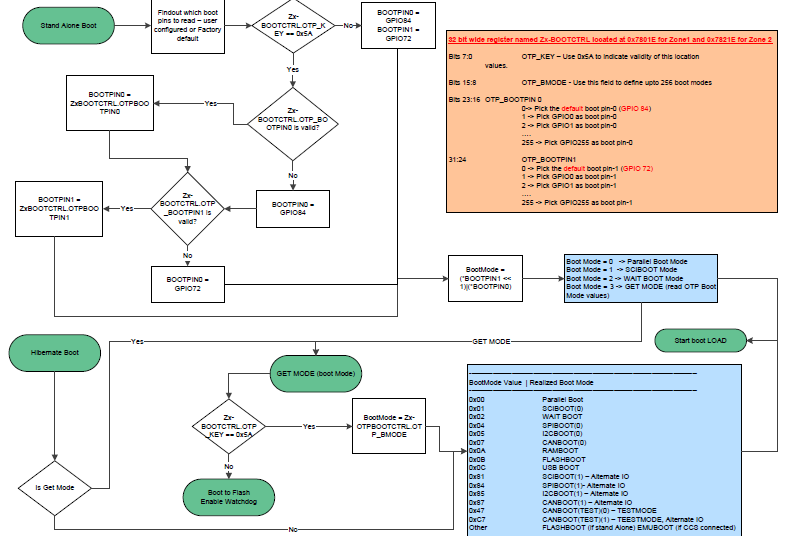

  • HI ,
    I have gone through the document, my clarification here is I am using internal flash for code storage and set the boot pins accordingly to boot from internal flash.
    In case if I want to upgrade the firmware through USB, I need to change the boot pins to USB boot mode (manually in hardware by strapping the GPIO pins from flash mode to USB boot mode) and this will download the updated version of my code + flash kernel from the host PC and update the latest firmware, once the firmware upgrade is done I need to manually set the GPIO pins to flash boot mode.
    My question here is can we upgrade the flash memory with this manual strapping of the GPIO pins , we need to update the firmware on the go with the host PC/Laptop , we can’t afford to take the board out from the mechanical assembly.
    Please advise me if I missed anything to read in the boot loader document
  • My question here is can we upgrade the flash memory without the manual strapping of the GPIO pins (to set the boot modes) , we need to update the firmware on the go with the host PC/Laptop , we can’t afford to take the board out from the mechanical assembly.
  • Hi Antony,
    As per my understanding you want to switch between Flash boot and USB boot without changing GPIO pins.
    Can you refer the section "2.1 Custom Boot Pin Selection" at http://www.ti.com/lit/an/spracn1/spracn1.pdf
    Let us know if this method works for you. Though the document is written for F28004x, the philosophy is similar.
    Thanks, Katta
  • Hi ,
    Thanks for sharing this app note .
    Look like for all the C2000 family of MCU Delfino , we need to use this scheme in order to avoid manually toggling the boot switch.
    In our existing project we have used Tiva series of MCU (TM4C1294NCPDT ) that has boot loader resides in the flash location that gives the flexibility for the user for remote firmware upgrade , we just thought the same for the C2000 Delfino Series of MCU.
