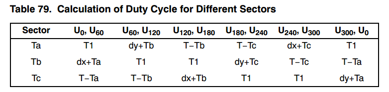

Hi, I am using F28379D microcontroller. I am trying to generator Space Vector PWM (SVPWM) for 3 phase inverter. I am going through the control suite example D:\ti\ti control suite\development_kits\HVMotorCtrl+PfcKit_v2.1\HVACI_Scalar where svgen_mf is used to generate SVPWM. I have a few questions about this.
Image 1 is the set of equations that are implemented in image 2 for SVPWM generation. I am confused about this implementation.
1. What is _IQ(1) here? The svgen_mf.h file code tells that _IQ(1) is 1 pu for 60 degrees. Then why is _IQ(1) used in Ta, Tb and Tc implementation? Please throw some light on this issue.
2. The dx equation that we need to implement is dx=Msin(60-alpha) (ref spru485a.pdf). But the equation implemented in the project HVACI scalar is this : v.dx = _IQsin(PI_THIRD-_IQmpy(v.NewEntry,PI_THIRD));
Why is M (the modulation index or gain) not being multiplied in this equation? And why is NewEntry which is alpha multiplied to PI_THIRD in this equation?

In normalized mode, 1pu represents 100%. It may be any parameter, be it angle or time. TI examples are based on this concept.
Reg M multiplication, pls spend some time to review the code.
