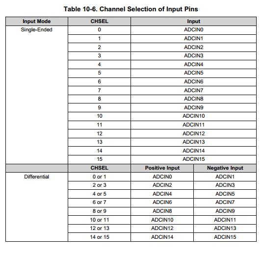

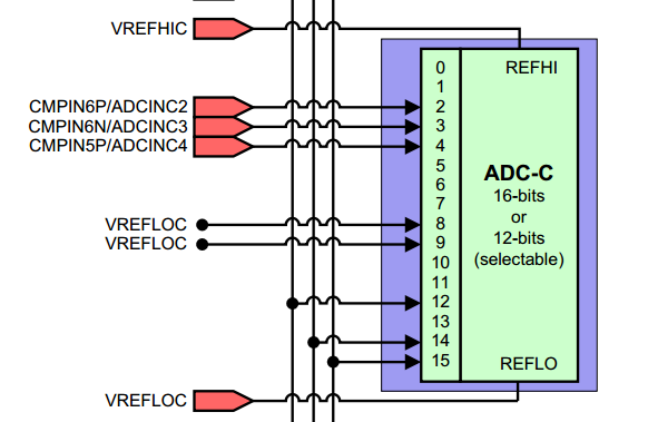

my customer wants to use 176-Pin F28377D. and they want to use the differential mode ADC.
but they found there is only ADCINC2 - ADCINC4 ,which means ADCINC4 can only support single mode ADC.Am I right?
by the way, I found for A-D ground ADC module. In my understanding, ADCINA0 is connected to ADC-A channel 0. Am I right?
But for all four ADC group, ch6-ch13 are not connected with any phisical pin, how to use these channels, ADCIN6 - ADCIN13?
    Yes, it looks like ADCC4 can be used in single mode only. I will confirm this and get back.
    Yes, thats correct.
    I will check this and get back.
