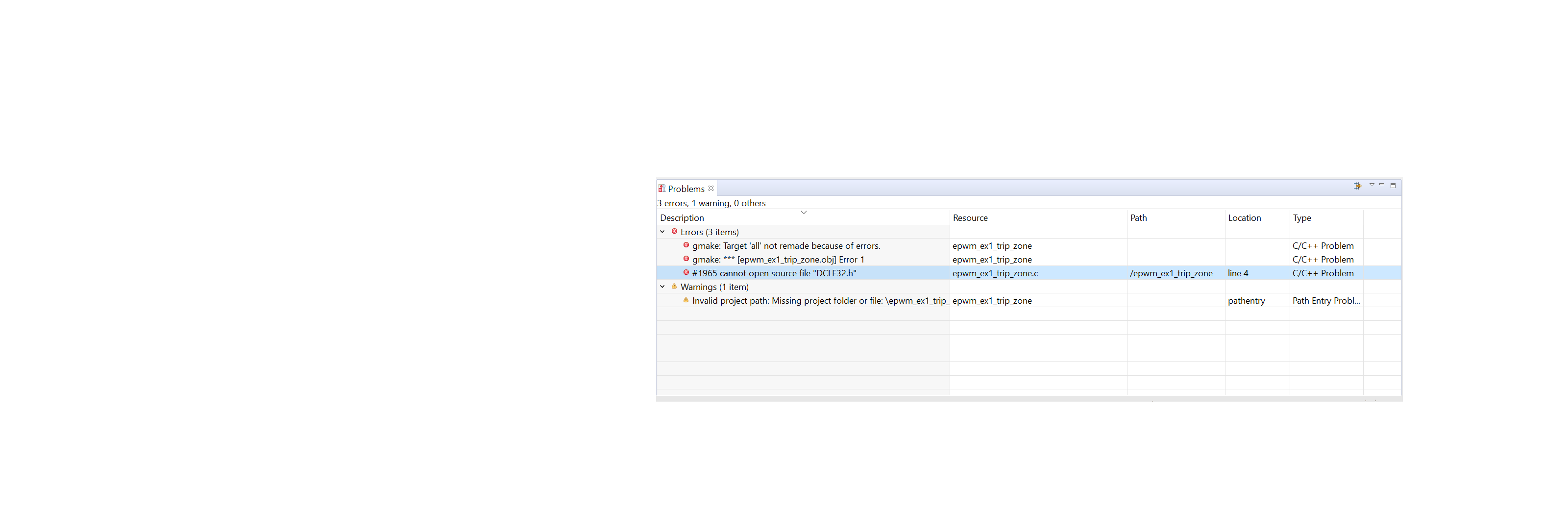

Hi Poley,
i have used this example but i still have problems with the header files, how can i add the header files from this example to my code, i have tried before but i always get errors when compiling.
YT
The error is telling you the compiler cannot find the header file. You can either manually copy the DCL headers into the include directory of your project, or (better) enter the DCL include path into your CCS project settings. In the CCS Edit perspective, right-click on your project name and select 'Properties'. Then navigate to "CCS Build -> C2000 Compiler -> Include Options". Enter the DCL path to the CCS include path window and click "Apply and Close". You should then be able to build without the error.
Richard

Hi Poley,
that solved my problem but i didn't go on with PI controls because i noticed a problem with ePWMs, it's about initializing the ePWMs. i want the ePWMs modules to zero at 0Volt from ADCresult. i want to use Trip zone and digital compare CMPSS for that, but i still find difficulties how to use it in my situation.
