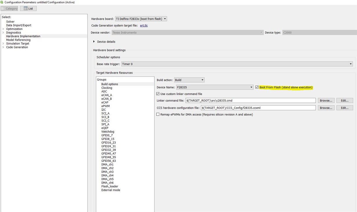

I'm running simulink models on an TI C2000 F28335 experimenter kit. The code runs in ram setting. I want to load the program in Rom Flash memory. How to load the simulink code in Flash memory.
I expect it ot run, when the power supply is taken away and then reapplied, but the code doesn't start running. Therefore, no standalone operation is possible. What's the procedure? Any document or video tutorial would be good. Thanks in advance.

    Please refer the below picture on option to configure for boot from flash.
  • Greetings venkatesh,
    I selected ert.tlc in system target file, which enables to choose Boot from Flash option. But i encounter a following error. How to rectify.
