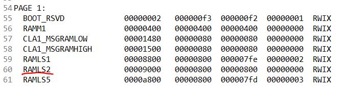

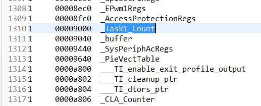

As the project is supplied, the Cla1DataRam memory (RAMLS2) appears to be full. Adding the counter to this memory should cause a build error.
Was the linker command file or project changed in some way to get it to build?
Please check the .map file to see where the counter ended up and if that memory is accessible by the CLA and CPU.
