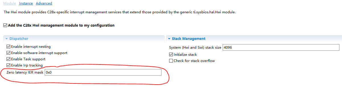

Derrick,
Thanks for your reply, test with two global variable, if timer preempte, one variable will plus one.
I checked again, I am not sure if this below is the cause.
In HWI module as below picture, the default value of the zero letency IER mask is 0x0. The timer use timer0, it correspond to INT1. So I can't use Hwi_disable(). I have not validated. I think that's may be the cause.

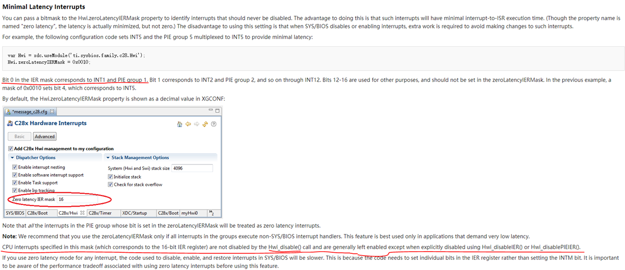

another picture from WIKI, that introduce the zero latency IER mask.

Frank,
Did you try wrapping your critical code with Hwi_disableIER()/restoreIER() calls to explicitly mask any zero-latency interrupts?
