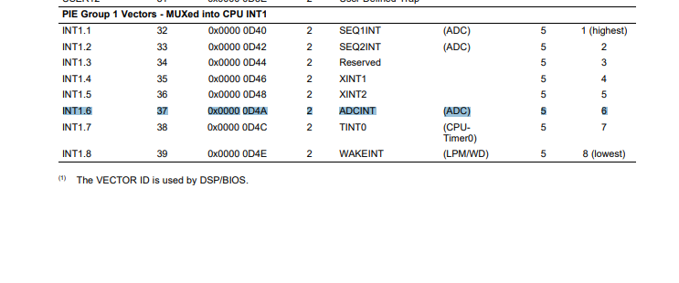

  • According to trhe 28335 data sheet, interrupt #37 is associated with the ADC:
    But I don't see a Hwi.create for interrupt 37 in the .cfg file.
    So, I'm thinking the ADC interrupt has been enabled but the vector for interrupt #37 has not been plugged, leading to the unplugged interrupt error.
    Alan

  • Marty,
    I'm not familiar at all with the ADC in this device so I'm not sure what the ADC ISR should be doing.
    However, since the application appears to be enabling the ADC interrupt, a corresponding Hwi must be added to service the ADC interrupt.
    Add something like this to your project's "testezDSP.cfg" file:
     var adcHwiParams = new Hwi.Params();
     Hwi.create(37, "&ADC_IntHandler", adcHwiParams);
    And you'll have to add the "ADC_IntHandler" ISR function to your C code accordingly and have it do whatever is required to service the ADC interrupt.
