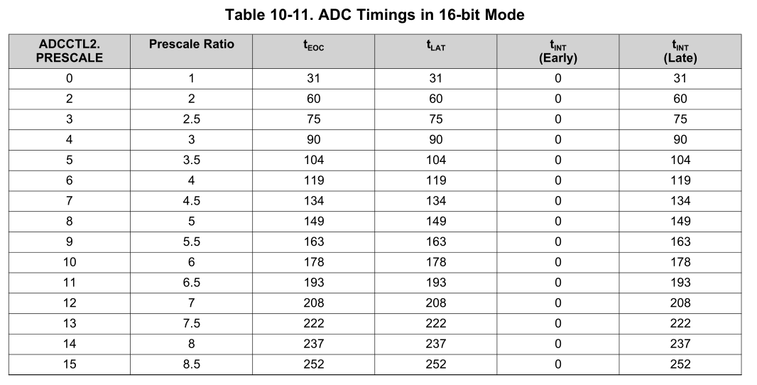

        And I notice that the ADC timings table in the reference manual as following:
       Is there any limitation to use the prescale? I notice that almost every example chooses 6 as the prescale, is it the best value?
       If I choose 6 as the prescale, than the whole time for a convertion will be (S+H time + t_EOC = 64 + 119 SYSCLK = 0.9us), is it right?

    On the table above, the ADC prescale is the divider that scales the SYSCLK (of 200MHz) that would feed the ADC clock.  ADC clock speed for the F28377D device has maxmum spec of 50MHz and the ADC prescale value of 6 reduces the SYSCLK to div 4  (200MHz/4) for the ADC.  Check the datasheet specification and TRM too for these details.
    As far as your adc timings calculation assumptions, yes that is correct.
