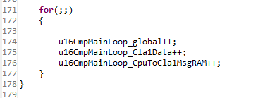

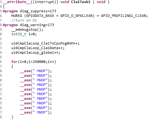

I would like to understand how to easily debug the CLA. To do so, I used the cla_ex3_background_nesting_task project. Then I added some variables placed in differents RAM (CPUTOCLAMSGRAM, CLATOCPUMSGRAM, shared LSRAM between CPU & CLA, LSRAM only for CPU). These variables are incremented at each loop in the Cla1Task1 function or in the main loop as you can see in my code below.
variables declaration
main loop
Cla1Task1
Then I tried to visualize the variables in debug mode with the Expressions windows (after connect and Load symbols). One Expressions windows is link to the CPU debug context, another one is link to the CLA debug context. I also visualize the RAM with memory browser at different address  @0x1480 (MSGRAM start address) or @0x9000 (start address of RAM LS2 ->Cla1DataRam)
I could display variables in real time on CPU debug windows almost as expected. However, I could not display variables on CLA debug windows even in step by step mode. However, I could access to memory with the memory browser. Please have a look at the picture below.
Is it the expected running mode or I forgot something?
Why could I not display the MsgRAM?
Thanks for your help.

  • Yann,
    Did you make any change in linker command file for cla (28004x_cla_ram_link.cmd) file?
    In the watch window in your setup, the variables are shown something like 0x00009001@Program. This does not look correct. It should be 0x00009001@data.
    Please check the generated map file.
  • To be sure, I started from the last project of the cla_ex3_background_nesting_task.
    Then I added my variables for test as I explained in my first post. I also removed the comment on__mdebugstop(); in Cla1Task1.  Then I compiled it.
    Here is the interresing part of the map file. It looks correct.
