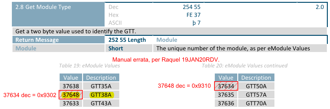

The display is eGTT50A from Matrix Orbital. It has an I2C interface that only carries commands from the MCU master (in this case the TMS320F28379D) to the slave (eGTT50A), and responses from the slave display back to the master MCU. All the heavy lifting regarding drawing graphics and text, and deciphering touch screen operations are handled inside the display module. In the grand scheme of things, there is very little communication between the two.

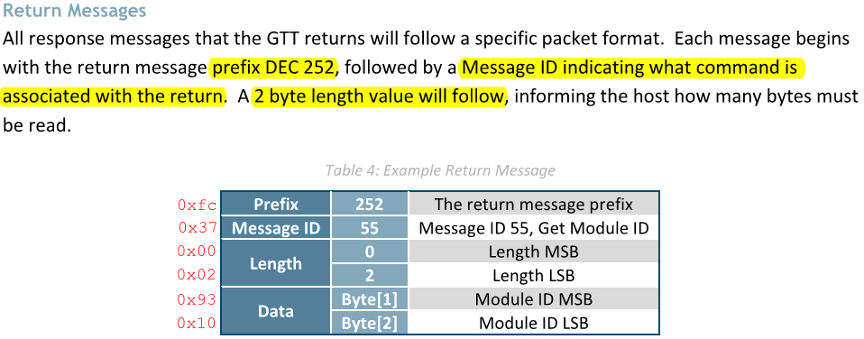

From the Matrix Orbital manual, here's the MCU master's request for a value embedded in the display's registers that indicate the module type: (0x28-write 0xfe 0x37)
And here's the expected response from the slave display to that request for module type: (0x28-read 0xfc 0x37 0x00 0x02 0x93 0x10)

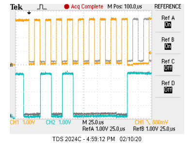

Here's a scope image of clock and data signals: (appx. 50kHz clock rate)

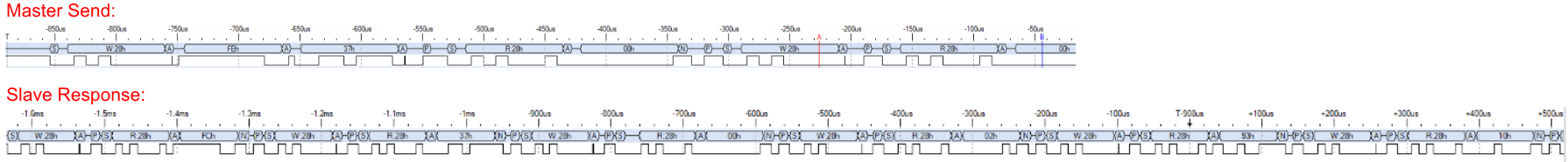

Here are logic analyzer images of the correctly working, complete transaction on the Arduino connected system: (I2c address = 0x28)
Here are the logic analyzer images of the failing transaction on the TMS320F28379D system:
The TMS320F28379D receives 0x00 into its I2CDRR ad infinitum.

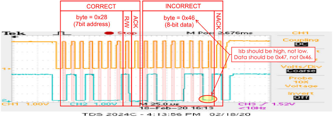

Here are a couple of scope traces that zoom in on one of those erroneous data bytes: (should be 0x47, not 0x46)
And zoomed in further on the data byte:
And here’s the logic analyzer readout of the same byte:
Here’s what’s new:
I noticed that the lsb wasn’t being held as close to zero as the other bits in the returned data byte. I suspected it was because the MCU was taking it low, not the display. By adding a resistor in series with the data line (SDA), we’re able to see that the TI MCU (TMS320F28379D) is in fact taking SDA low during the lsb of the data byte. Since this data byte is being returned by the display, the MCU should be hands-off until the NACK has occurred.
I added a resistor in series with SDA, so I could determine precisely which device was taking the data line low. Here’s where I added the resistor:
Following is an image of scope traces. The blue trace is taken from the display side of the resistor, and the green trace is taken from the MCU side. The pullup resistors are at the display end of the I2C bus. Clearly, the MCU is driving SDA low, as is evidenced by the line not going as near ground in the blue trace. Here it is:
Finally:
So, the question is: “Why is the TI TMS320F28379D MCU taking the data line (SDA) low during the least significant bit of the data byte that is being returned by the display?”

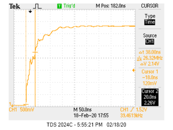

I don’t think it’s an SCL or SDA rise-time issue. As seen in the scope images, the edges are pretty crisp. Here are close-up images: (fall-times are shorter)
SDA rise-time is ~46ns and SCL is ~38ns. SPRS880K spec’s max timing requirements as 300ns:

However, the F28379 is taking SDA low during the lsb of all data bytes received from the display.
Again, in different words, all data transmitted by the slave display is being corrupted by the F28379.
The F28379 is interfering with the display's control of SDA by taking SDA low during the lsb of the display's data.
The F28379 doesn't interfere with the display's address response, but it does interfere with all of the display's data responses.
Here's the image again, with some new info added in blue:

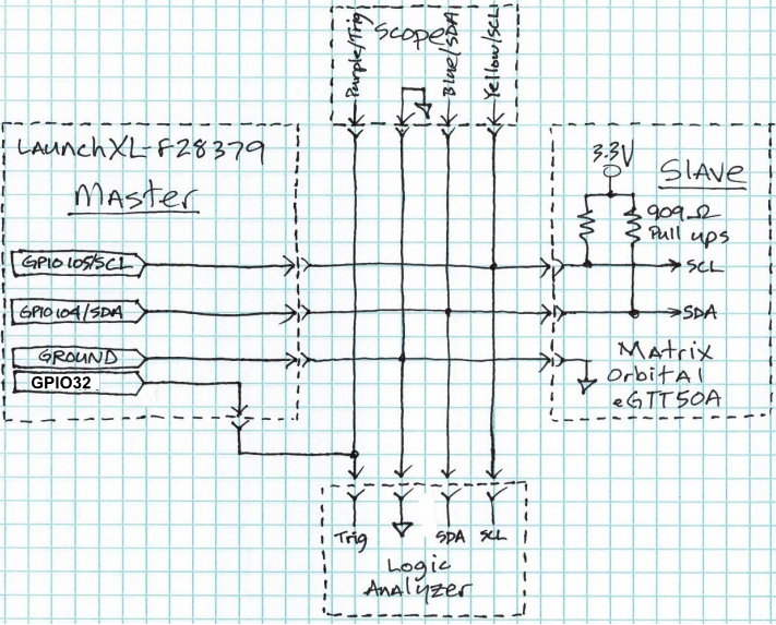

There is no series resistor on SCL or SDA lines.
There is one each 909 Ohm resistor pulling up to 3.3V on SCL and SDA at the slave end.
Here's a quick scheme:

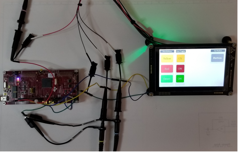

Here's an image of my bench setup:
I2C ports assigned in the example code (GPIO32 and 33) aren't exposed to the user on the LaunchXL-F28379. I assigned GPIO 104 and 105 instead. Here's the assignment:

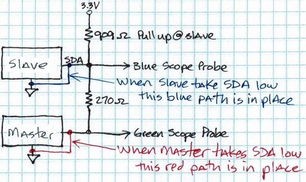

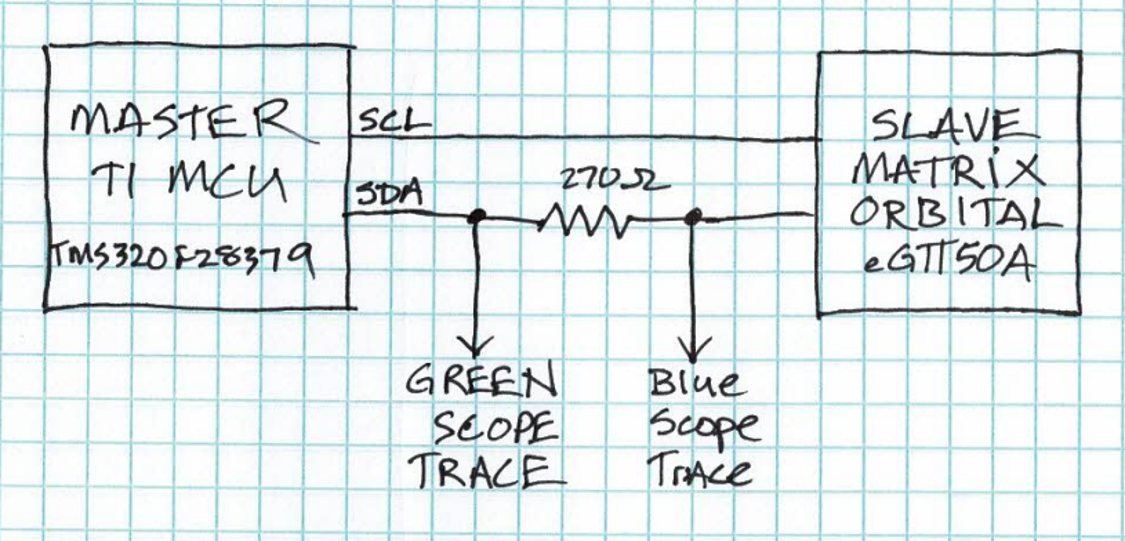

Instead I took another look at bus levels with a resistor in series with the SDA line. I'm very convinced it is the f28379 that is taking the SDA line low. Here's another look at it:
Here's how it works:
Scenario 1: Slave takes SDA to logic zero
The BLUE connection is made and the voltage level where the blue scope probe is connected goes to zero. The voltage level on the green scope probe goes to zero as well, because there's no pullup resistor at the master end of the bus.
Scenario 2: Master takes SDA to logic zero
The RED connection is made and the voltage level where the green scope probe is connected goes to zero. The voltage level on the blue scope probe is a bit above zero, due to the voltage divider caused by the 270 Ohm resistor in series with the 909 Ohm pullup resistor.
You would expect the voltage at the blue probe to be:
(270 / (270 + 909)) * 3.3V = 756mV
As can be seen in the image above, the difference between the green and blue scope traces is pretty close to 756mV.
This is pretty conclusive. If you want me to further experiment with it, let me know what you'd like to see.

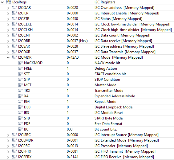

It's been a long day (month), and I'm a little loopy, but I think I found the problem.
In initialization, I set the I2COAR register to the same address as the slave.
I'll take a closer look in the morning, but I'm pretty sure that's it.
I'll let you know what I find out.
robin
Hi Manoj,
I've confirmed the final issue with my bidirectional I2C communications was that I had inadvertently assigned the same I2C address to both the master and slave.
As a result, responses from the slave (display) were being interfered with by unwanted responses from the master.
