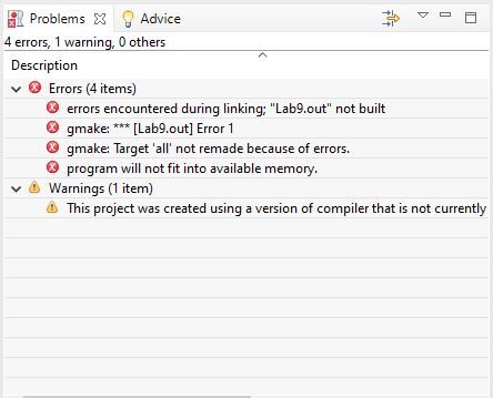

The problem I'm running into is that the .out file is not getting built. I'm suspecting that it has to do with the error line saying that the line
".cinit   : > L0SARAM,    PAGE = 0"
does not fit into memory.
Here are the error outputs:
Building target: "Lab9.out"
Invoking: C2000 Linker
"C:/ti/ccs930/ccs/tools/compiler/ti-cgt-c2000_18.12.4.LTS/bin/cl2000" --silicon_version=28 -g --diag_warning=225 --large_memory_model --unified_memory --cla_support=cla0 -z -m"Lab9.map" --stack_size=0x200 --warn_sections -i"C:/ti/c2000/C2000Ware_2_01_00_00/libraries/math/IQmath/c28/lib" -i"C:/ti/ccs930/ccs/tools/compiler/ti-cgt-c2000_18.12.4.LTS/lib" -i"C:/ti/ccs930/ccs/tools/compiler/ti-cgt-c2000_18.12.4.LTS/include" --reread_libs --xml_link_info="Lab9_linkInfo.xml" --rom_model -o "Lab9.out" "./Adc.obj" "./ClaTasks.obj" "./Cla_9.obj" "./CodeStartBranch.obj" "./DSP2803x_GlobalVariableDefs.obj" "./DefaultIsr_9_10.obj" "./DelayUs.obj" "./ECap_7_8_9_10_12.obj" "./EPwm_7_8_9_10_12.obj" "./Filter.obj" "./Gpio.obj" "./Main_9.obj" "./PieCtrl_5_6_7_8_9_10.obj" "./PieVect_5_6_7_8_9_10.obj" "./SysCtrl.obj" "./Watchdog.obj" "../DSP2803x_Headers_nonBIOS.cmd" "../Lab_9.cmd" -l"C:/ti/c2000/C2000Ware_2_01_00_00/libraries/math/IQmath/c28/lib/IQmath.lib" -lrts2800_ml.lib
<Linking>
"../Lab_9.cmd", line 38: error: program will not fit into available memory.
placement with alignment/blocking fails for section ".cinit" size 0x77 page
0. Available memory ranges:
L0SARAM size: 0x800 unused: 0x74 max hole: 0x74
error: errors encountered during linking; "Lab9.out" not built
>> Compilation failure
makefile:151: recipe for target 'Lab9.out' failed
gmake: *** [Lab9.out] Error 1
gmake: Target 'all' not remade because of errors.
**** Build Finished ****
