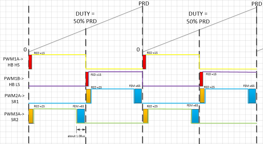

After the initialization (source code:D:\ti\controlSUITE\development_kits\TMDSHVRESLLCKIT_v1.0\HVLLC), PWM work work as show below:
SR PWM will turn off about 1.08us before HS when FEM = 65.
The trip zone configuration  forces the SR signal on anytime the SR current is greater than the value of DACVAL.
// Configure ePWM Trip-Zone module
EPwm2Regs.TZCTL.bit.DCAEVT1 = TZ_FORCE_HI; // EPWM2A will go HIGH
EPwm3Regs.TZCTL.bit.DCAEVT1 = TZ_FORCE_HI; // EPWM3A will go HIGH
So,the time that SR PWM  turn off  before HS is less than 1.08us when FEM = 65.

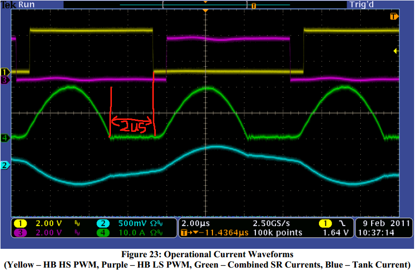

But ,the time which in the Figure23 of  "HVLLC-SWGuide.pdf" is abuot 2us.
I had noticed,the FEM CAN be changed by the GUI.

    You're right, it doesn't look like FEM = 65 in Figure 23 of the user guide.
    1) My understanding for this reference design is that FEM is fixed, unless the user changes it. The user can change the value of FEM through the watch window in CCS. The user should be able to see how the switching waveforms change as the PWM values are changed.

    2) The default value assigned to FEM at initialization is 65 from the HVLLC-Settings.h file, but as you've pointed out, the value of FEM in figure 23 likely isn't equal to the default value. I don't see a description in the user guide that says what the conditions were when that figure was captured, so it was probably after the step instructing the user to "carefully adjust REM{x} and FEM{x} to see how they affect the Rectifier PWM signals", or even in build 3 with the comparator action active.
    If you find line 343 in the HVLLC-Main.c file and then you right click "FallingEdgeMargin1" and select "Open Declaration" (Keyboard shortcut F3), CCS will take you to the place where the default value is defined.
    When the code is running on the device, you can open the watch window and read/modify the value of FEM1, FEM2. You could also inspect the DBFED register of the PWM2, PWM3 to get the current value of FEM.

    In general, I think you'll be safe to set the FEM value in this TMDSHVRESLLCKIT design to To/2, and let the comparator control the exact turn-off timing of the SR PWM.
