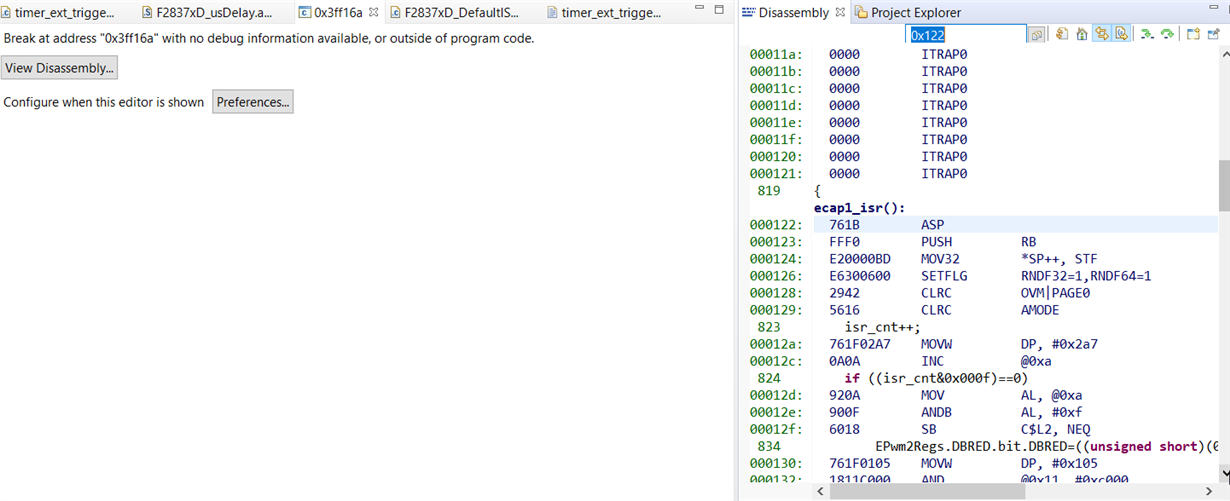

  • Dear Vivek,
    I have made some screenshots to clear the situation. Please look at the attachment.
    Best regards
    Ralf
    The reset is issued from the debugge1.pdf

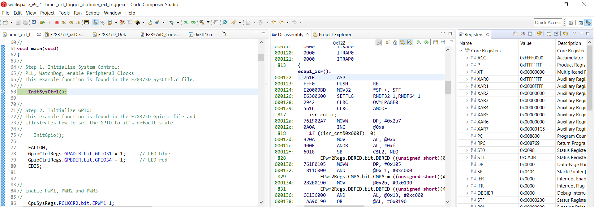

    As long as no reset is issued everything works fine. The next picture shows the disassembly when the DSP is reset and the program counter points to the reset vector. At this point the mnemonic at address 0x122 is ok (ASP).

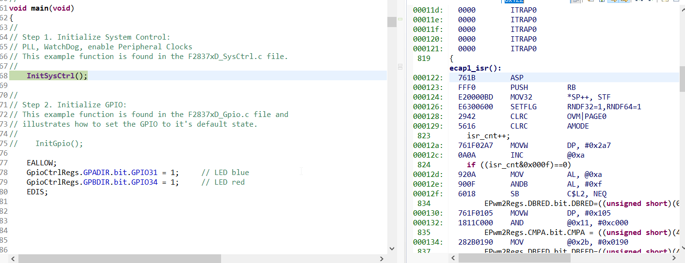

    Now the DSP is started and runs to main().
    Here you can see, that the boot routine has overwritten the mnemonic at address 0x122. The ASP instruction is replaced with an ITRAP0! This is the reason for the illegal interrupt.
    Why is the address 0x122 overwritten by the boot routine?

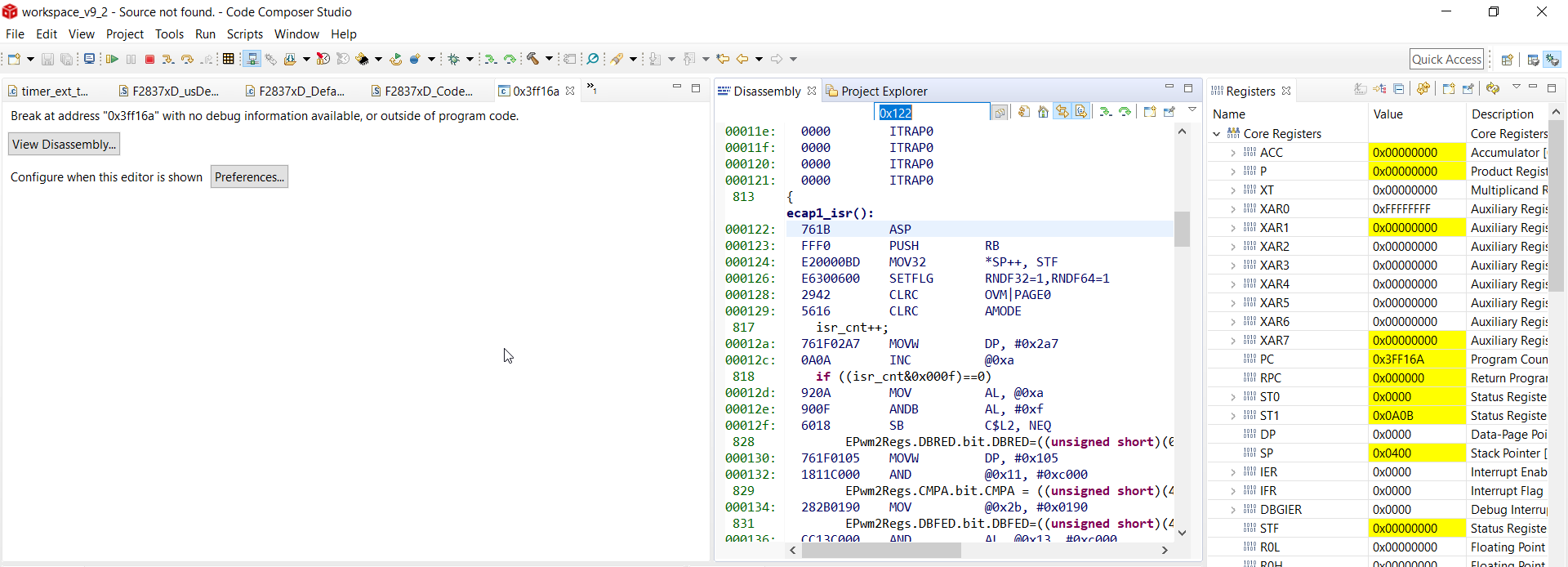

    After that the EMU_BOOT_MODE is switched to SARAM and a reset is issued.
    The program counter is set to 0x3ff16a. The code at address 0x122 at this time is still ok.
    Now I have set a breakpoint at codestart and run the code.
    The program counter stand at address 0x000000. At this time the code at address 0x122 is overwritten!

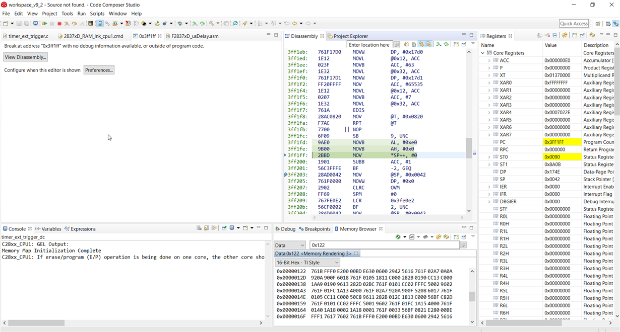

  • Dear Vivek,

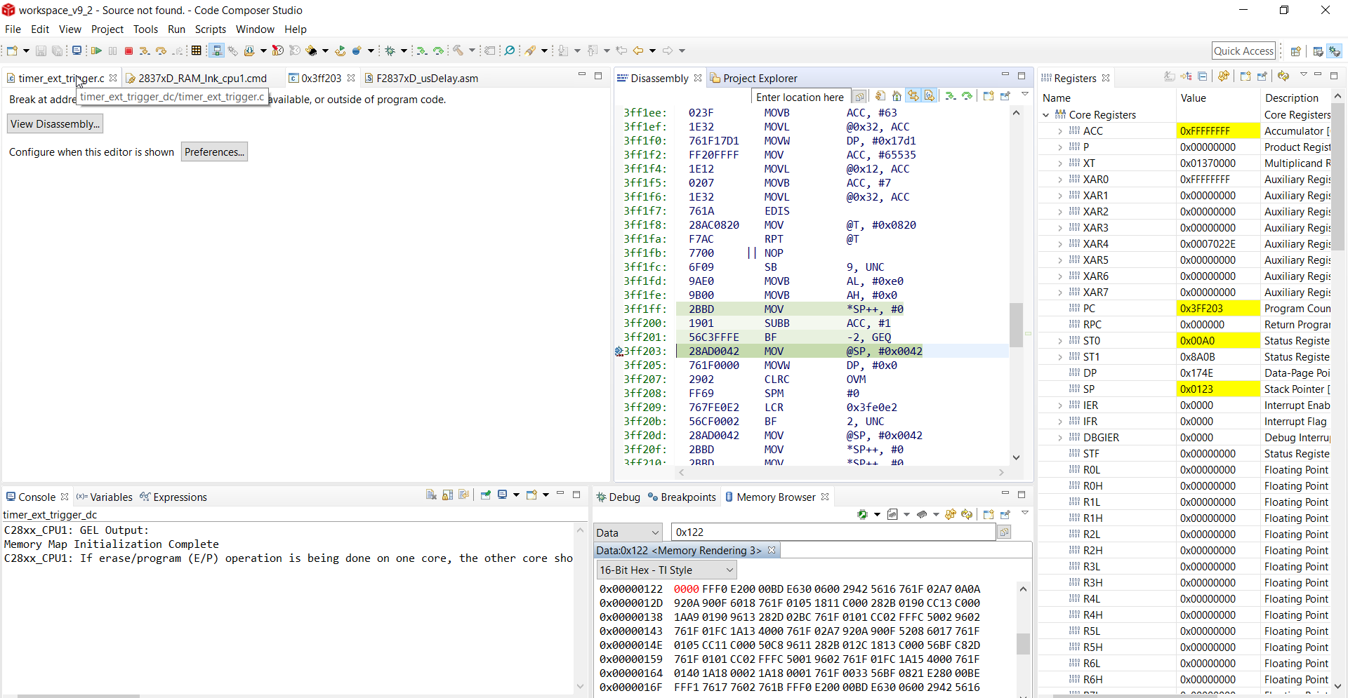

    I think I have additional informations. I have made a single step through the bootloader.
    At adress 0x3ff1ff is a loop which writes zeros into the memory. The screenshot shows the time when the SP contains 0x42. At this time accumulator holds 0xe0, the number of the loop counts. You can see at address 0x122 in the memory windows the correct opcode.
    I have set a breakpoint at 0x3ff203 (after the loop).
    After the end of the loop the opcode at address 0x122 is overwritten with zero (see memory window).
    Is this a problem in the bootroutine?
    Best regards
    Ralf
  • Hi Ralf,

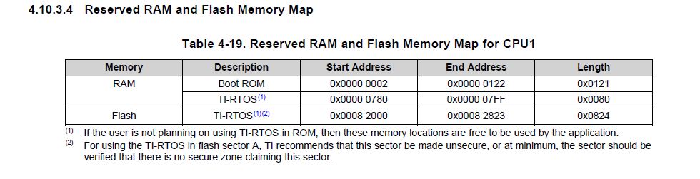

    Thanks. I used CCS "Hardware Watchpoint" feature to halt the CPU on write to 0x122 address and I can see the same thing. That section of the code in BOOTROM is doing stack initialization and 0x122 is the last location hence it is getting initialize.
    I looked into the device TRM (BOOTROM section) and it is mentioned there that RAM from 0x02 to 0x122 is reserved for BOOTROM usage. Please see the below snapshot from device TRM.
    So you should not use that location for your code. I looked at the sample linker cmd file provided in C2000Ware and that has an issue. In that definition of M0 is from 0x122 which is not correct. It should be 0x123. Please correct this in your linker cmd file and that should help.
     RAMM0            : origin = 0x000122, length = 0x0002DE
    We'll correct the sample linker cmd file in next release.
    Thank you for debugging this and our apology that this has caused the inconvenience to you.
