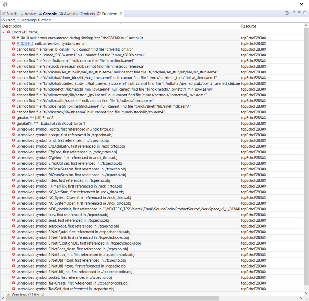

I tried to build the Ethernet project tcpEchoF2838X. I imported the project from CCS v9.1.0 from the C2000Ware 2.01.00.00. I also install the NDK (ndk_f2838x_3_61_01_01) and NS (ns_2_60_01_06). My XDC tool version is 3.60.02.34 (xdctools_3_60_02_34_core) and the sysbios is bios_6_76_04_02. In the project include option, I added the path of NDK and NS. When I build the project, I got bunch of errors of "cannot find file".
I am appreciated if you could give some advice on this.
One more thing that I am not able to find the download site of ndk_f2838x_3_61_01_01 and ns_2_60_01_06. I got these SDK from another post.The latest NDK on the download page http://software-dl.ti.com/dsps/dsps_public_sw/sdo_sb/targetcontent/ndk/index.html is 2.25.01.11. What is the SDK download page?

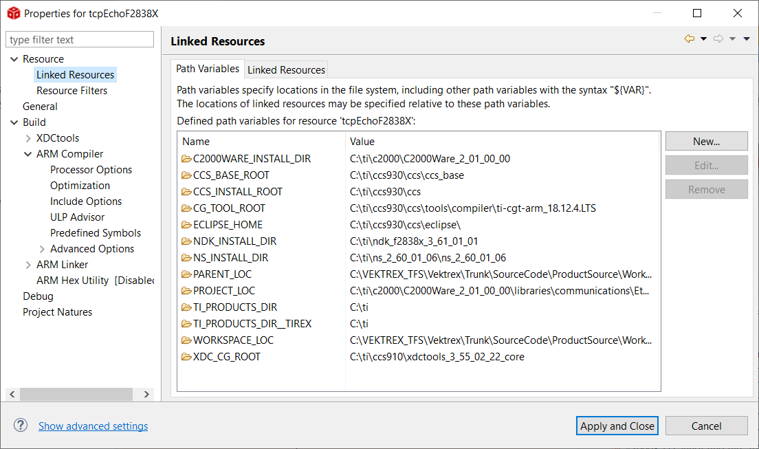

  • Thanks for the reply.
    I went through the document. I upgraded my CCS from v9.1 to v9.3 and changed the xdctools path in the Project Include Options to "C:\ti\ccs930\xdctools_3_60_02_34_core". I added those path variable following the instruction in Readme.md.
    But I still got those same errors when trying to build it.

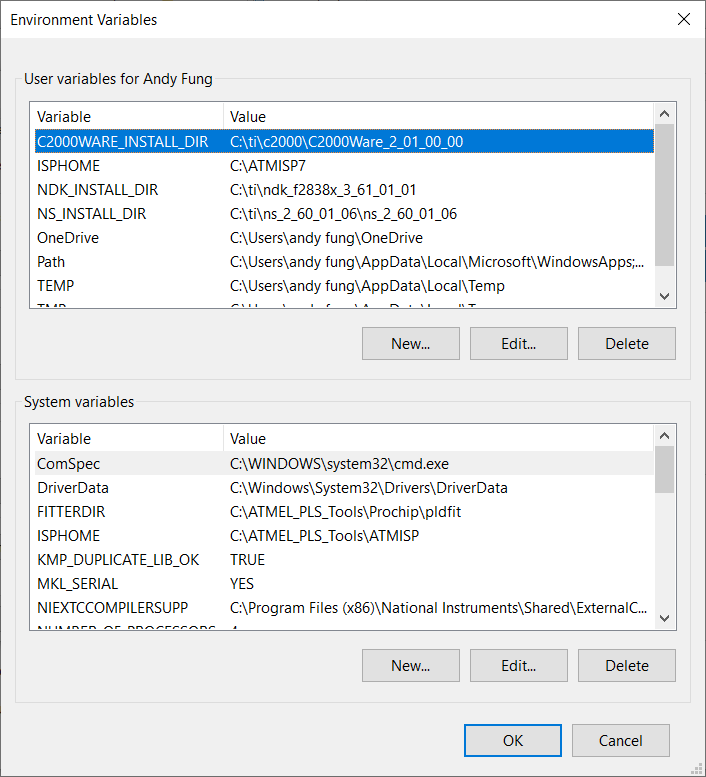

    The three environment variables NDK_INSTALL_DIR,NS_INSTALL_DIR,C2000WARE_INSTALL_DIR have to be set in windows, not in CCS path variables. Can you set that and let me know if it helps.
    Sudharsanan
  • I set those environment variables in window. But still getting the same errors.

  • Now I got the build successful now. I have to add the those aem4 library in ARM Linker->File Search Path.
