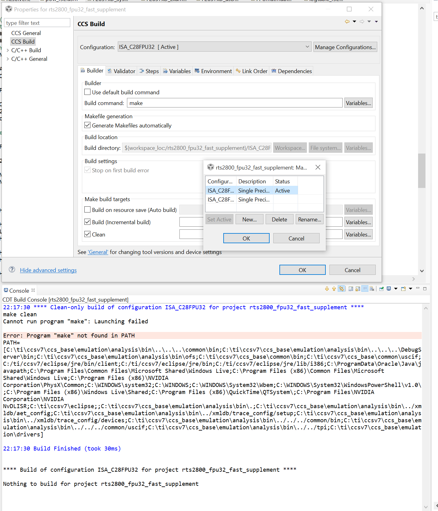

  • Hello Richard,
    We have tried rebuilding the project but are having an issue (see screen dump).
    We get an Error Message 'Program "make" not found in PATH'
    Can you suggest where we are going wrong?
    Scott
  • Hello Scott,
    I'm sorry you're facing this issue.  Below are a couple of references which may help.  Could you take a look at these please?
    http://software-dl.ti.com/ccs/esd/documents/sdto_ccs_build-errors.html#ccs-gmake-errors
    https://e2e.ti.com/support/tools/ccs/f/81/t/607701
    Please let me know if either resolves the issue.  Thanks.
