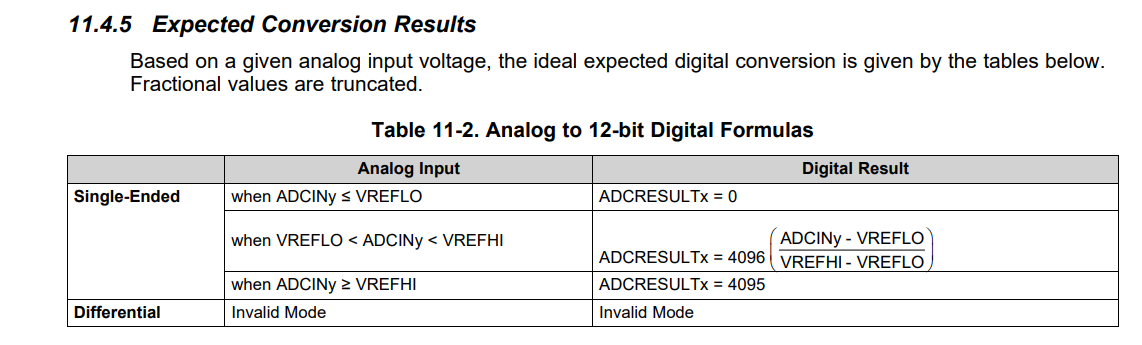

    When you applied 4V was there anything to limit the current?  If you apply 4V with a low impedance source, the ADC inputs will almost certainly be damaged (see DS excerpt below):
    In your second case, I'm not sure I follow how the voltages are correctly corresponding to the input voltage.  If the VREFHI is nominally 3.0V, then 4V should max out the output (4095) and 2.25V should give roughly (2.25/3.0)*(4096) = 3413 (see TRM excerpt below):
