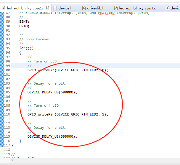

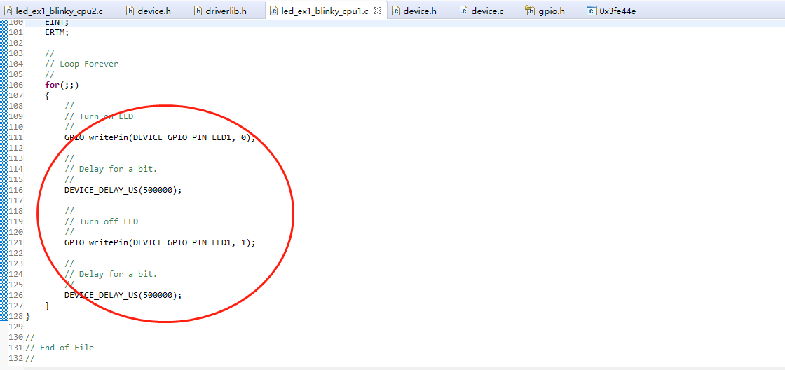

    7: I changed  "led_ex1_blinky_cpu2.c"  DEVICE_GPIO_PIN_LED2"  to "DEVICE_GPIO_PIN_LED1"   ,such as" cpu1.c"  , then download it to run ,  this time led cann't  run .
    8 : I set breakpoint in cpu2.c ,  program can stop at it's port.  that inpove it is runing .
    At end , I want to ask : if  cpu1 and cpu2 can not use same gpio or some other problem ?   ( 28379d launchpad xL)

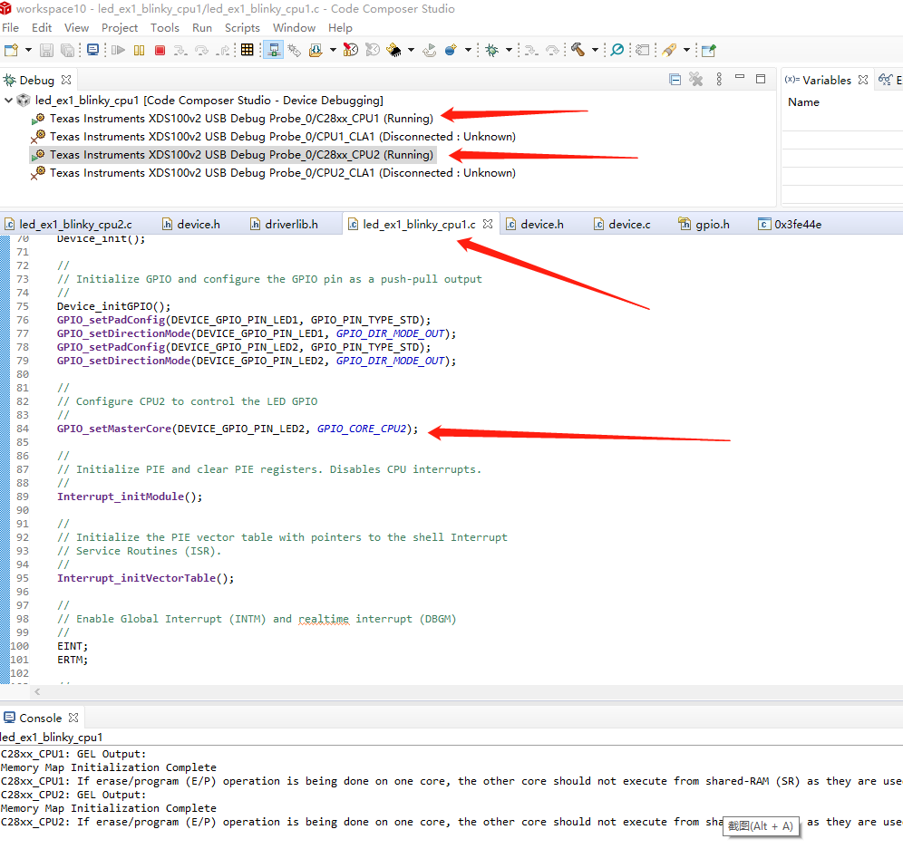

    If you have downloaded, the firmware for CPU1 and CPU2, then it should behave as follow
    CPU1 will toggle DEVICE_GPIO_PIN_LED1 --> GPIO31 (D10, BLUE)
    CPU2 will toggle DEVICE_GPIO_PIN_LED2 --> GPIO34 (D9, RED)
    You have to load CPU1 first, and it sets master core for GPIO
    // Configure CPU2 to control the LED GPIO
    GPIO_setMasterCore(DEVICE_GPIO_PIN_LED2, GPIO_CORE_CPU2);
    If you want CPU2 to toggle DEVICE_GPIO_PIN_LED1, then you need to make corresponding changes in CPU1 main() function to set the master core for GPIO and also in CPU2 code for doing actual toggling of GPIO. Then it should work.
  • hi thanks your replys JHa.
    But ,  it is still no work.
    As your said.    the original program of C2000ware done like that .
    The cpu1 and cpu2 configuration as your said.    this is c2000ware orignal code.
    I first download cpu1. then download cpu2. after these operation ,  I click "run" at cpu1. and click "run" at cpu2.   at this time the LED1  can run . but LED2 can not run .  can you try it  use your launch pad 28379d?
    thanks & regard!
