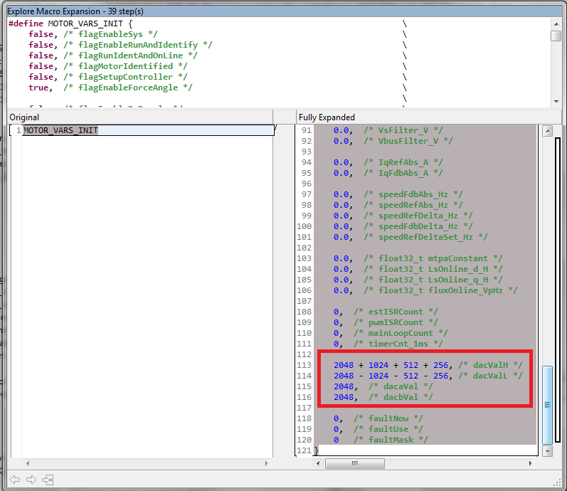

The debug register refresh DACHVAL DACHLVAL load value changes after a Trip zone event occurs and never reloads the init values.  I notice the DC filer sample clock value 0x100 (256) but not the DACLVALS 4048 and 0xF00 (3840) DACHVLA has changed the init value 0xFD0. This occurs on all 3 CMPSSx. The initial load values 0xFD0 are correct but only after MCU reset is forced via CCS debug.
Any idea why CCS register DACH/L values are not reloading after a PWM trip event or why they are changing?  Perhaps this issue leads to frequent annoying low side DAC filter faults?

    Lab is05_motor_id.c has over written the HAL_setCMPSS's(void) settings that previously initialized. However the DACHVAL and DACHVAL in the motor.Vars.dac(a/b)Val were not set by anyone and over write above registers with odd count values. Where did the 0x100(256) originate was the question in my mind and why it messing with the Low side comparator DAC filter and trip latch events.
            // set the reference value for internal DACA and DACB
            HAL_setDACValue(halHandle, 0, motorVars.dacaVal);
            HAL_setDACValue(halHandle, 1, motorVars.dacbVal);
            // set internal DAC value for on-chip comparator for current protection
                uint16_t  cmpssCnt;
                for(cmpssCnt = 0; cmpssCnt < HAL_NUM_CMPSS_CURRENT; cmpssCnt++)
                    HAL_setCMPSSDACValueHigh(halHandle,
                                             cmpssCnt, motorVars.dacValH);
                    HAL_setCMPSSDACValueLow(halHandle,
                                            cmpssCnt, motorVars.dacValL);

    Change of sign below for DACB load value ignores negative half cycle sine-wave needs to be inverse 2048 down to 0 counts. It would be nice to use signed integers for DACB and sample filter if the DAC(L/H)VALS register/s will allow such folly, the C+ array will.
        2048 + 1024 + 512 + 256, /* dacValH */
        2048 - 1024 - 512 - 256, /* dacValL */
        2048, /* dacaVal */
        2048, /* dacbVal */
        uint16_t  dacValH;
         int16_t  dacValL;
        uint16_t  dacaVal;
         int16_t  dacbVal;
        3848, /* dacValH */
        -3848, /* dacValL */
        3048, /* dacaVal */
        -3048, /* dacbVal */
        uint16_t cmpsaDACH = 3840;//2048
        int16_t cmpsaDACL = -3840;//2048
