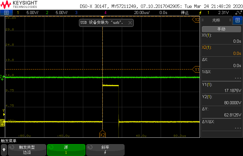

Hi:
when USE DB_ACTV_HIC to initial ePWM , a unexpected  plus occur on EPWM1B when execute initial, the display as below:
CH1: Trigger signal  CH2:EPWM1B,      EPWM1A is always low( do not display on scope)
the initial code:
EPwm1Regs.AQCTLA.bit.CAU = AQ_CLEAR;
EPwm1Regs.AQCTLA.bit.CAD = AQ_SET;
EPwm1Regs.AQCTLB.bit.CBU = AQ_CLEAR;
EPwm1Regs.AQCTLB.bit.CBD = AQ_SET;
EPwm1Regs.AQSFRC.bit.RLDCSF = 3; //The active register load immediately
EPwm1Regs.AQCSFRC.bit.CSFA = FORCE_LOW; //FORCE the EPWM2A output LOW
EPwm1Regs.AQCSFRC.bit.CSFB = FORCE_HIGH; //FORCE the EPWM2B output HIGH
EPwm1Regs.DBCTL.bit.IN_MODE = DBA_RED_DBB_FED; //EPWMxA In is the source for rising-edge delayed signal.
EPwm1Regs.DBCTL.bit.DEDB_MODE = 0;
EPwm1Regs.DBCTL.bit.POLSEL = DB_ACTV_HIC; //Active high complementary (AHC). EPWMxB is inverted.
EPwm1Regs.DBCTL.bit.OUT_MODE = DB_FULL_ENABLE; //Enable dead band time configuration
EPwm1Regs.DBCTL.bit.OUTSWAP = 0;
EPwm1Regs.DBRED.all = EPWM1_DBRED;
EPwm1Regs.DBFED.all = EPWM1_DBFED;

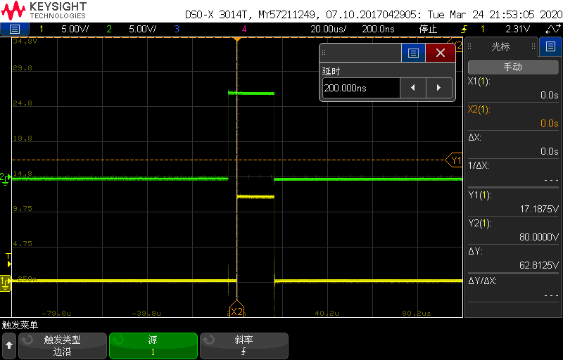

then change to DB_ACTV_HI, the display as below:
the initial code:
EPwm1Regs.AQCTLB.bit.CBU =AQ_SET ;
EPwm1Regs.AQCTLB.bit.CBD = AQ_CLEAR;
EPwm1Regs.AQCSFRC.bit.CSFB = FORCE_LOW; //FORCE the EPWM2B output HIGH
EPwm1Regs.DBCTL.bit.POLSEL = DB_ACTV_HI; //Active high complementary (AHC). Neither EPWMxA nor EPWMxB is inverted (default).
Between the two plans ,the first give EPWM1B force high then inverter in  DBCTL[POLSEL], the second give EPWM1B force low then Neither EPWMxA nor EPWMxB isinverted  in  DBCTL[POLSEL].
The initial code is execute in sequence, the two plans  should have same output on EPWM1B,  why the fisrt have a 20us high pluse.
Addition information:
fpwm:20kHz
EPwm1Regs.CMPCTL.bit.SHDWAMODE = CC_SHADOW;
EPwm1Regs.CMPCTL.bit.SHDWBMODE = CC_SHADOW;
EPwm1Regs.CMPCTL.bit.LOADAMODE = CC_CTR_ZERO_PRD;
EPwm1Regs.CMPCTL.bit.LOADBMODE = CC_CTR_ZERO_PRD;
  • Supplement:
    In the first plan , EPWM1A and 1B have same value and action, use DBCTL[POLSEL] to inverte EPWM1B, and use DBRED and DBFED to set DEADBAND time.
    In the second plan , EPWM1A and 1B have same value and Complementary action, use +/- Dtime value  to set DEADBAND time.
    Prefer the first plan ,but can not  accept the unexpected high pluse when initial.

  • HI:
    Thanks for you reply.
    As my post above , i use DB_ACTV_HI to dismiss the unexpected plus.But about DB_ACTV_HIC,  before EPwm1Regs.DBCTL.bit.POLSEL = DB_ACTV_HI, i set the EPwm1Regs.AQCSFRC.bit.CSFA = FORCE_LOW;   EPwm1Regs.AQCSFRC.bit.CSFB = FORCE_HIGH;.
    The initial code is execute in sequence, so i think the high plus shouid be the execute time of the two code between . The execute time should less than 20us , why the high plus have 20us
    the post you suggest is less than  20us
