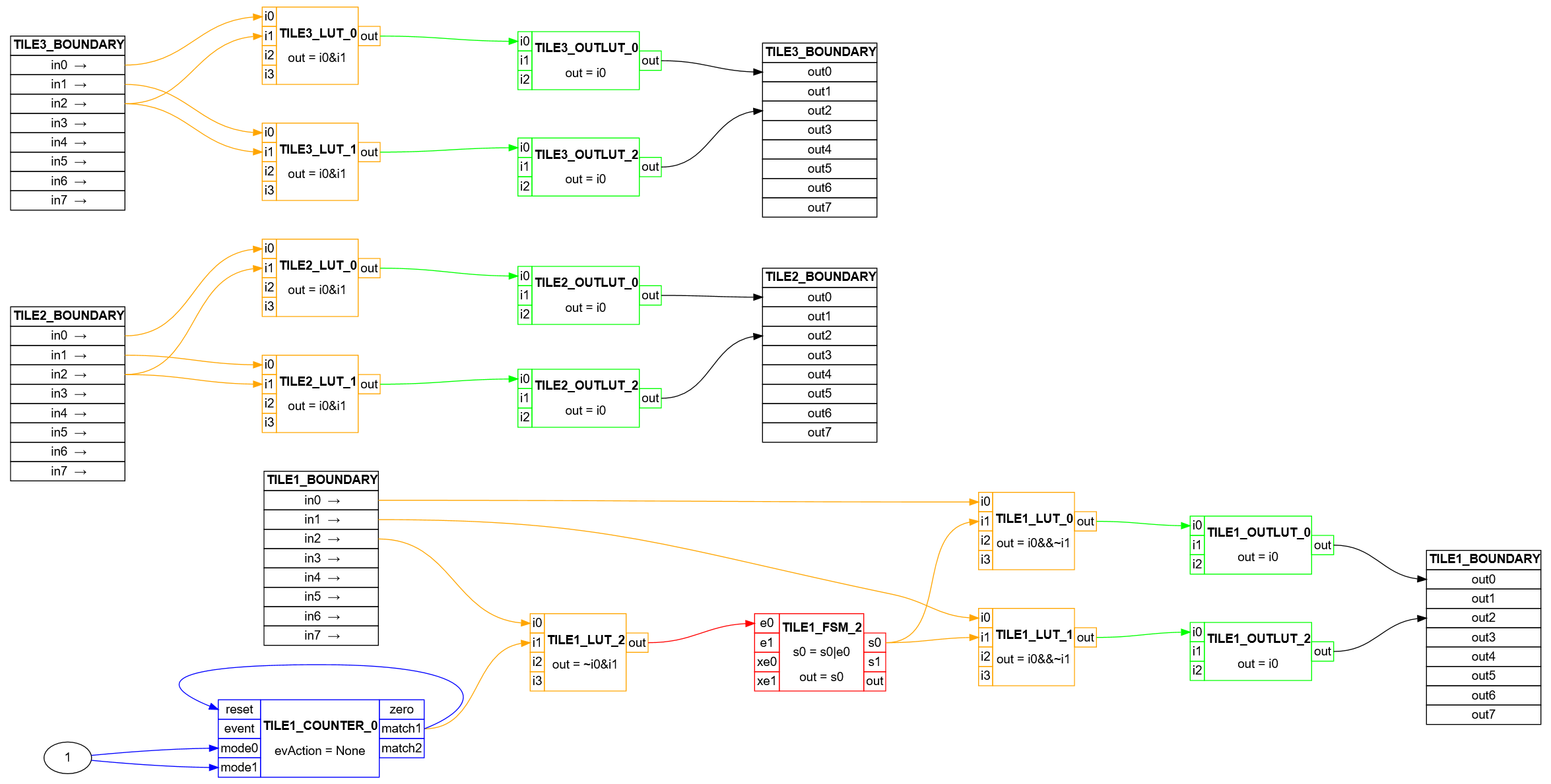

I route 3 ePMW input corresponding to tile 1 to tile3, and output different duty cycle respectively:
CLB_configGlobalInputMux(CLB1_BASE, CLB_IN0, CLB_GLOBAL_IN_MUX_EPWM1A);
CLB_configGlobalInputMux(CLB1_BASE, CLB_IN1, CLB_GLOBAL_IN_MUX_EPWM1B);
CLB_configGlobalInputMux(CLB2_BASE, CLB_IN0, CLB_GLOBAL_IN_MUX_EPWM2A);
CLB_configGlobalInputMux(CLB2_BASE, CLB_IN1, CLB_GLOBAL_IN_MUX_EPWM2B);
CLB_configGlobalInputMux(CLB3_BASE, CLB_IN0, CLB_GLOBAL_IN_MUX_EPWM3A);
CLB_configGlobalInputMux(CLB3_BASE, CLB_IN1, CLB_GLOBAL_IN_MUX_EPWM3B);
But I found that if the PWM output logic of tile1 was pulled low by TILE1's logic. at the same time, the PWM output of tile2 and tile3 is pulled low, which is very strange, I don't know why?
Hope for your response, thank you!
The logic is as follow:
There must be an error in your input setup.
I think what is happening is that for some reasong TILE2 and TILE3 are still using EPWM1 signals.
Here is what must be checked,
1. Check your LOCAL input mux setting, make sure it is set to GLOBAL.
2. Check to make sure that GPREG is not used as the input instead of the LOCAL and GLOBAL mux.
3. Change the logic for TILE2 and TILE3 to see if pulling their outputs low affects EPWM1
Overall, it seems that EPWM1 is used as the input for TILE2 and TILE3 so when you pull EPWM1 low in the logic of TILE1, it affects the other TILEs.
Let me know what you find!
Nima
The TILE2/3 output is the duty cycle of pwm2AB / 3AB's configuration, but if the TILE1 's output is blocked, the output of TILE2 and TILE3 is abnormal
And I checked the LOCAL input mux is set to GLOBAL , meanwhile the GPREG is not used
I go on finding what happened.

Were you able to find out what was causing this? It is most definitely a setup issue.
Hi Nima,
We analyze the independence of three PWM channels and find that the three PWM channels use the same time benchmark, but the input and output of PWM channels are controlled independently. But the root cause has not been found
Can you test each of the tiles independently? Take out the other 2 tiles and test only 1 tile at a time?
Hi Nima,
I have resolved the issue yesterday. During the ePWM configuration, the pwm-bar's input are routed to one channel.
Thank you.
